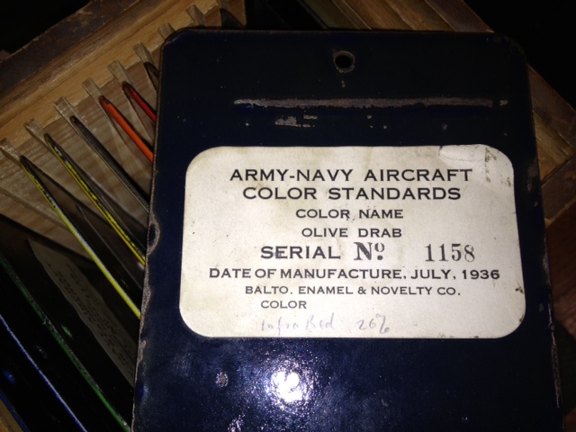

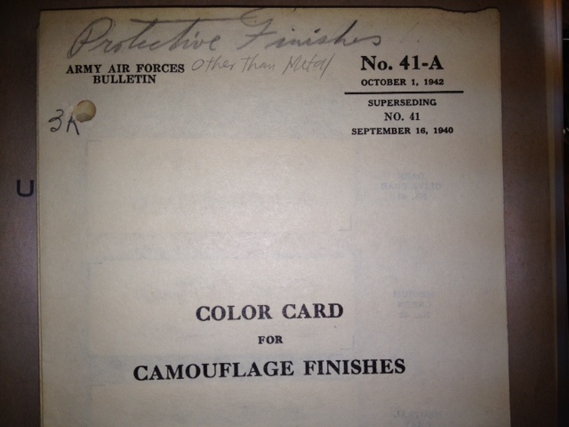

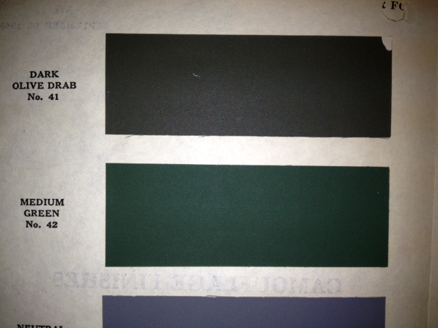

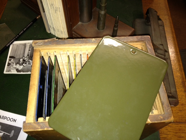

The closest I can come is Bulletin 41-A dated October 1, 1942 which superseeded Bulletin 41 dated September 16th, 1940.
I have the enamel plates that pre date Bulletin 41 which were before the assigned two and three digit color numbers. This is Olive Drab:
And the later color cards dated 1945
Thank you!

Taigh,
Thanks for posting those wonderful photos and information. I believe when we eventually find bulletin 41 the Olive Drab may approximate the OD you show here from the pre-war enamel color set #1158 dated 1936 except in a flat finish.
Was there a gray color included in enamel set 1158 along with the olive drab ? I f I am unable to locate bulletin 41 I may consider using 1158 as a basis for the O-58A.
Again, Thank you very much for posting this information.

From my findings/research along with color photos of the period I believe that you will not see that much variation in the shade from bulletin 41, 41-A and throughout the rest of the war for Olive Drab paint used on aircraft.
Take a look at all of the different original color photos of the pre war and early war aircraft and compare them to the later war shots and they look just like the original samples and original plates I have here. It's hard top tell in the photo of the plates above from the crude iPhone photos but all of my samples are very close to each other. It is my opinion that the variation you see in field shots is a matter of the different paint manufacturers variances and how each of these would fade at different rates and in different ways.
I have found that TM9 paints has reproduced a very accurate shade that matches what I have both in original parts and the color cards.
Certainly your mileage may vary but a variation is not only acceptable but documentable.
Thank you!
To your point they are all very similar. QMS Olive Drab #41 was in use starting in 1940 and is supposed to be the same as ANA 613 but when dry #41 is lighter and when they fade 41 fades more brown while 613 stays darker and fades more to the green tint.
Thanks again for posting those excellent photos.

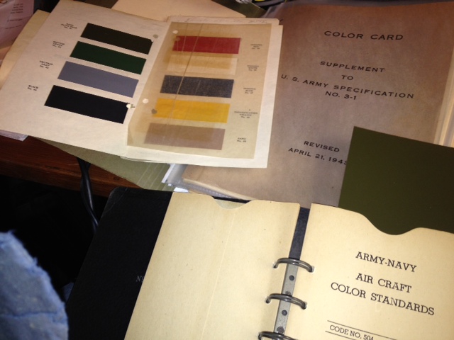

Taigh, I will scan and post photos of the color cards from this 1943 book I purchased as soon as I can for you.
https://www.facebook.com/photo.php?fbid ... =1&theater
Best Regards,
Steve
https://www.facebook.com/groups/2282629 ... ref=SEARCH
https://www.facebook.com/groups/1062859 ... 8743408401
