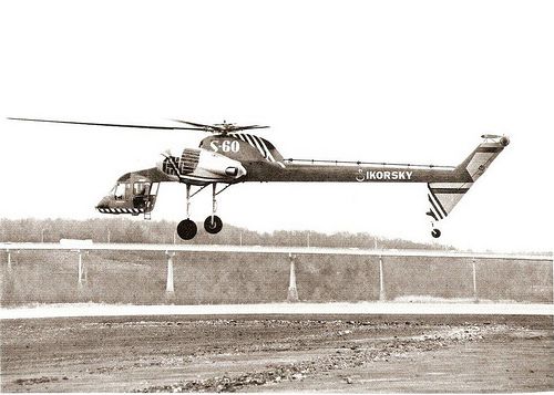

Shame you can Skycrane it out.
Gas her up and git 'er done, Drew!
