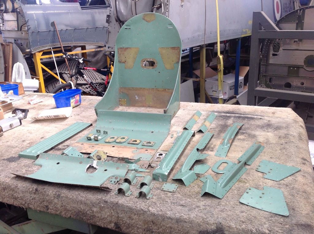

Just continuing the follow-up for anyone interested in these seats, Ashley Briggs in Melbourne is restoring a CAC Boomerang for the Moorabbin Museum, and has started working on the seat, which is very similar to the Wirraway (round-backed) seat.
Photo of the dismantled Boomerang seat from Ash if anyone is interested:

For those interested in the above picture of the Boomerang seat, the aircraft behind it are a P51 flanked on either side by P40's, the P51 being overhauled after a wheels up landing...
The Boomerang is being restored for a local museum. Ash is currently working on a newly manufactured hydraulic shelf as the old one was fizzing away...
