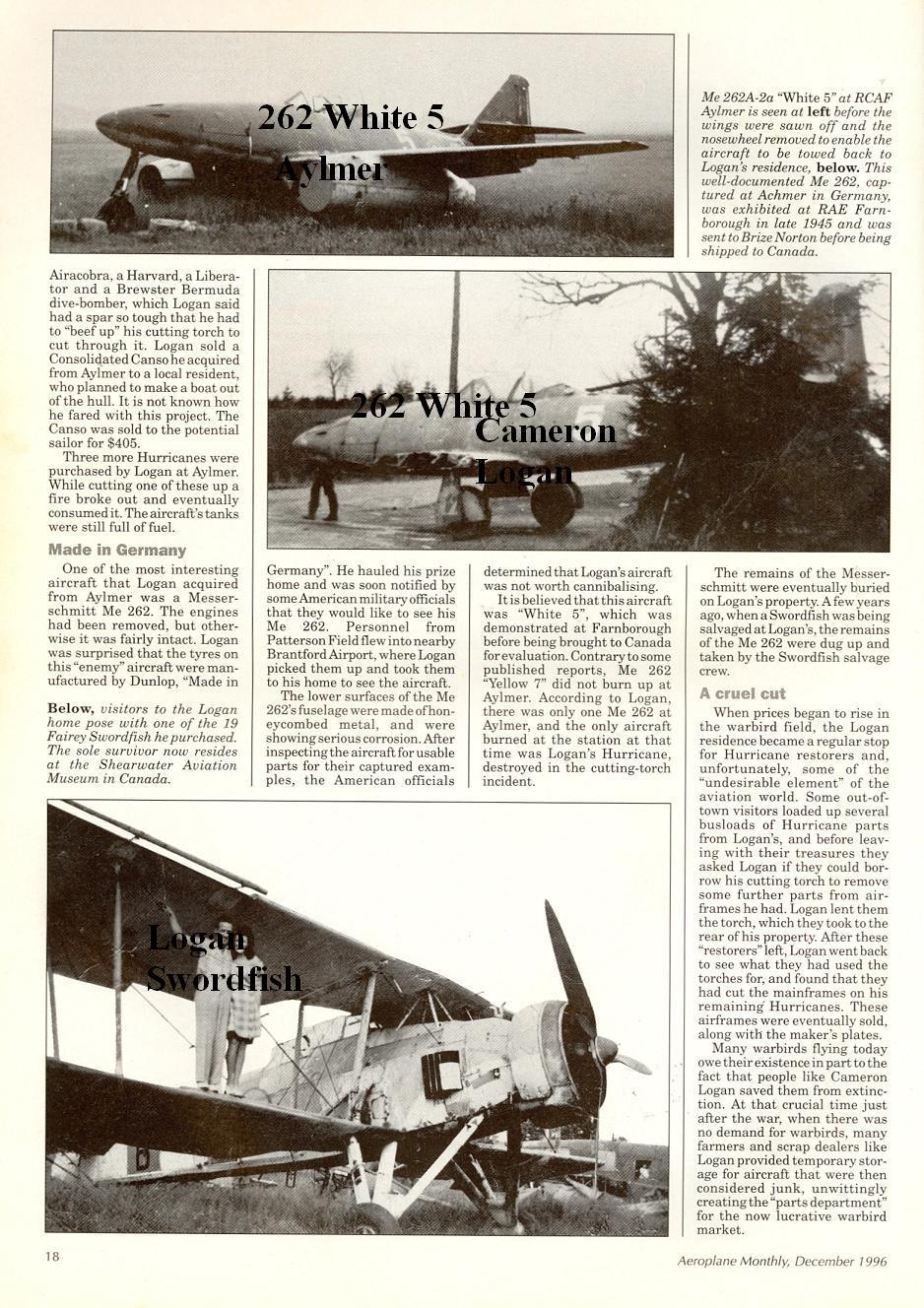

Some more info sources on the Shearwater example, which is apparently a survivor of the salvaging efforts at the Cameron Logan farm.
This 2004 thread from Flypast...
http://forum.keypublishing.com/attachme ... 1096481272
http://forum.keypublishing.com/showthread.php?t=32473
And this 1996 article from Aeroplane monthly:
http://3.bp.blogspot.com/_JhcYAAtlcWw/T ... ogan+3.jpg
