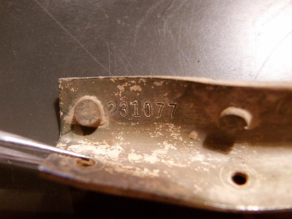

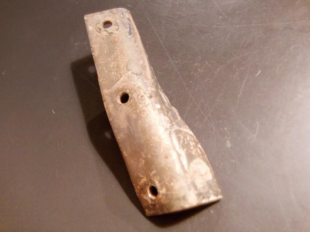

Hey everybody. Looking for a little help here. A co-worker of mine comes up to me and tells me that near where he lives he thinks he's found the crash site of an aircraft. I guess neighbors told him that a WW2 bomber crashed nearby. In this field by his house he's found bits and bobs indicative of a crashsite. I.E. melted aluminum, fragmented plexi, hard line tubing (like hydraulic or somes such) and some other items including a stitched rubber sole of a shoe. The crash site is located within a mile or 2 of what is now Dayton International Airport. But during the war it was Dayton AAF and I think I recall that one of it's functions was that of a Bomber modifications center. So there is that.
Ok the part itself is pretty vague but I'm just curious what the wealth of experience and knowledge of WIX has to say about it. It's a rectangular piece of aluminum measuring 2.63 inches in length. It has 6 holes in it with 3 of them still containing odd looking rivets. I looks like the peice may have originally been flat and used to butt together 2 other pieces and hold them together. There is what appears to be part number: "231077". There is another stamped crooked number but it's almost illedgible: Kinda looks like "(R20)" but not sure.
I guess what I'm asking is does anyone recognize this type of piece? Also can anyone cross ref the part number to gleam any info like maybe a manufacturer? Anyone recognize these type of rivets and what they were typically used for?
This was the only piece found so far with a part number. If nothing else may to revisit the site to find more clues.
Thanks
Shay

The 231077 is a good number to be used to ID the wreck
Lockheed P-38, part numbers begin with 19,20,21,22,23,24+
Looks like you found the crash site of this plane
431202 P-38J 42-67127 ASTB Flight Sec Dayton Muni Airport, Vandalia,OH KCRGC 5 Posey, Harry P USA OH Dayton Muni Airport, Vandalia, OH
Killed in Crash Ground Collision
DaveT

Wow,thanks Dave.That's more info than I ever thought would be gleamed from this one little piece. I'll let my co-worker know what you've found and I'm sure it'll motivate him to find more artifacts to tell the pilot's story.
Thanks again
Shay
