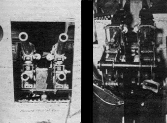

20mm is the biggest I've seen.
http://www.ww2aircraft.net/forum/attach ... cannon.jpg

Here's a quad .50 set up in the nose of a PBY. Reminds me of a short story I read recently by Stephen Coonts, called the "Sea Witch". It's about a PBY "Black Cat" crew in the S. Pacific. They field mod their bird with 4 .50 Cal machine guns in the nose section, only he describes them as being two per side and the front turret gunner having to straddle the ammo cans in order to operate his own set of .30 Cals.
I'm thinking the set up pictured would only be good for a land based bird...otherwise water would be coming into the forward compartment?
