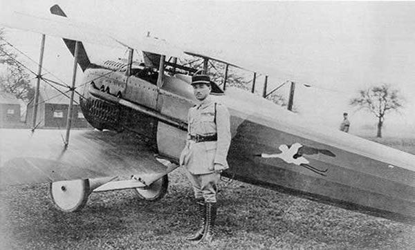

The cannon through the prop hub was I believe first used on the SPAD XII in WW1. There's a cannon Hispano Suiza engine w/37mm cannon on display at Udvar Hazy, and apparently at the AF Museum as well:
http://www.nationalmuseum.af.mil/factsh ... sp?id=9501
SPAD XII
Little known fact, the SPAD XII had a control wheel instead of a stick because the breech of the cannon stuck back into the cockpit-
