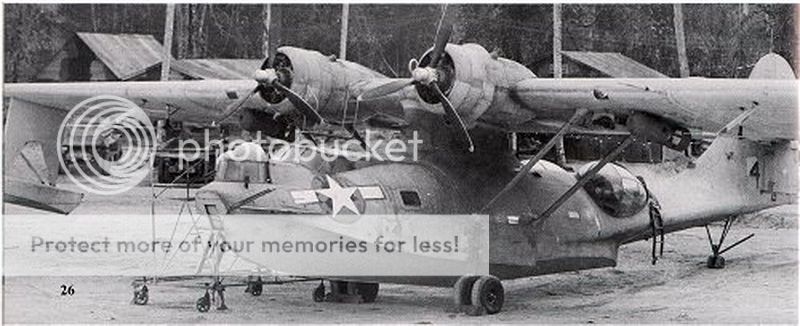

Remembering that I've already seen a different example, I quickly found this photo from VP 71:
Probably there are more.
Does anybody know was this a field mod? Are the 2 turret types interchangeable?

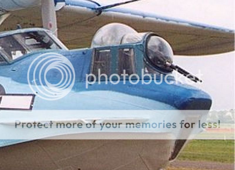

Actually I've seen some Catalinas restored with the same turret. Like this one in the National Warplane Museum (I guess):
But they are really not many...
Yves Marino

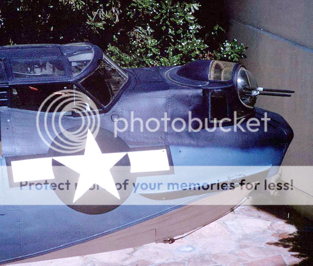

I would say the new turret is known as "Eye ball" not only in Australia. :D This is the usual name for it all over the world (I guess). There are some small differences between the one I have shown above and the modified type wit a metal hatch as below.
There is also an old thread in the forum about the "clipper bows" and other changes made to the "Catalinas" here.
BTW all the "Catalinas" shown in "Tora, tora, tora" have the eye-ball turret and the wing thermal de-icing system, which is incorrect for the historical period.
And speaking of movies: the "Cat" in "The Battle of Midway" is also some "back-to-the-future" :D aircraft with a clipper bow and a high tail of a PBY-6A:
But once again my initial question: does anybody know how do you open the hatch of the eye-ball turret? There are no hinges and I guess the hatch must be removed completely (to the inside?)
Certainly, the early turret had the removable top panel which is held in place by 4 over centre clips with the hatch removed completely to the inside of the aircraft or outside on a lanyard.
As to the eyeball turret, logic would dictate the it must have still had a removable top panel for ease of mooring and continuance of existing operation procedures
