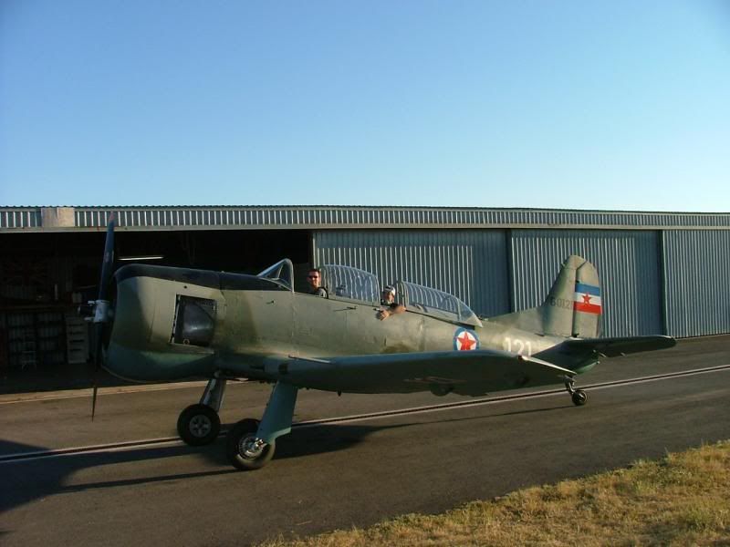

A Soko 522 has arrived in a container at my local Airport (Rand Airport, Germiston, South Africa)
I must admit that I would never have expected to see one of these here :shock:
Does anyone know how these craft perform ? ... Better or worse than a Harvard ?
Also, how many of these are still around in flying condition ?
Pic taken by a friend who is ok with me reposting.

Finally managed to get to see the Soko 522 at Rand Airport today.
Still dont know which one it is as I could not find a data plate.. but no doubt someone on WIX will be able to help.
It looks to be one of those 90% complete projects and in good condition ... lets hope the final 10% does not take 90% of the time !!

Soko 522 at Rand Airport (FAGM) 22 Feb 2014
