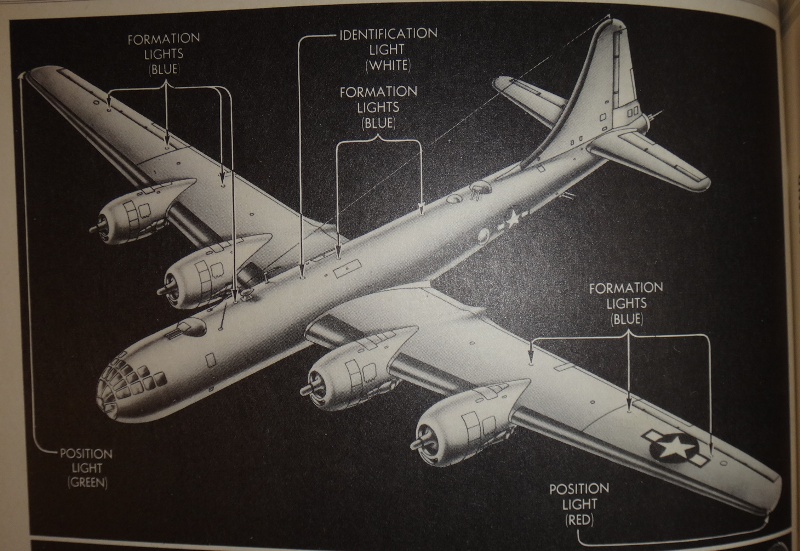

Does anyone have a diagram/pic for the exterior lighting for the B-29. I'm starting a build on the 1/48 monogram superfort now. I'm having problems actually finding pics, I'm mainly looking for the nav, recognition and especially the formation lights.
B-17's have a single white light on each side of the vertical tail, does the 29 have the same?
I know the 29 has the blue formation lights, should be 3 on the fuselage spine, the kit only has one, are there 3?
The ones on the wing are supposed to be a foot aft of the rear spar, and outboard of engines 1 and 4, but I cant find pics so I know where to put them.

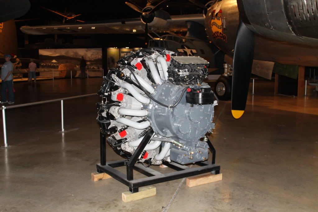

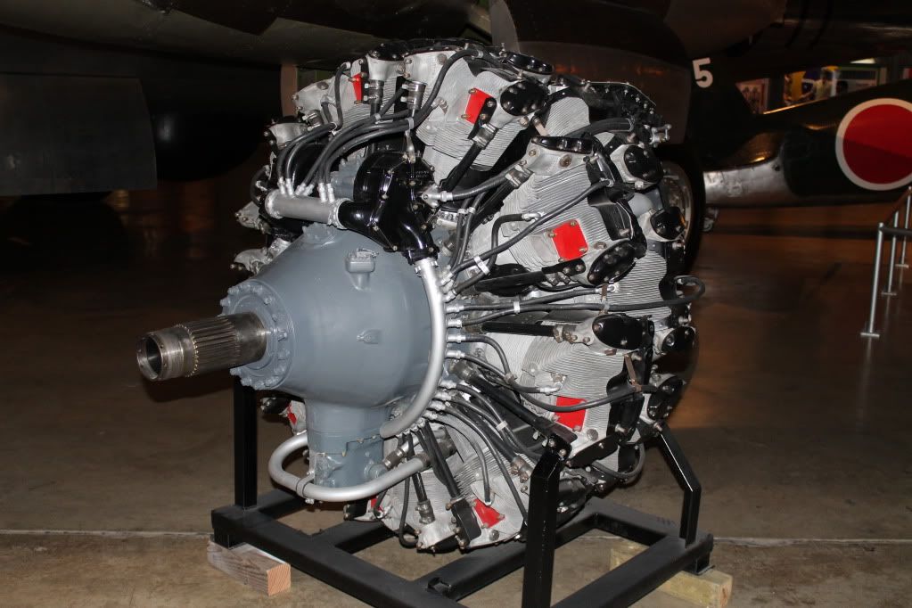

Oh, and engines! The kit has what look's to the older 3350's, not like the new hybrids, and good straight on pics of fifi's old engines? Showing any oil lines to/from the crankcase housing? I'm confused on this part.

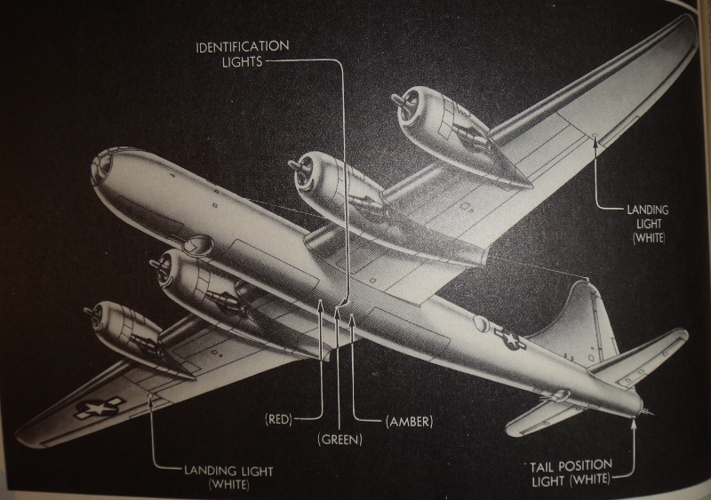

This is from an early B-29, Boeing produced Familiarization manual. I would think that most of the lighting would be the same for the later production aircraft but I do see that the recognition lights on the belly would have been moved because the APQ-13 radar was installed between the bomb bays. The formation lights should be the same. I would also add a red/white formation bombing light to the tail. I think it was above the tail gunners glass.
I don't recall ever seeing white lights or any light on the side of the tail on the B-29 or the B-17. What reference do you have for this?

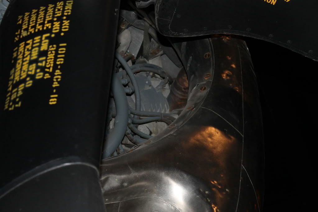

I have a couple of Bockscar engine pictures looking through the cowl but they aren't great.
Image[/URL]
Image[/URL]
And here are a couple pics of the engine on a stand if they help.
Image[/URL]
Image[/URL]

Greg, the last 2 engine pics will help greatly!
Taigh Ramey, that diagram is exactly what I've been needing and cant find, thank you sir!
