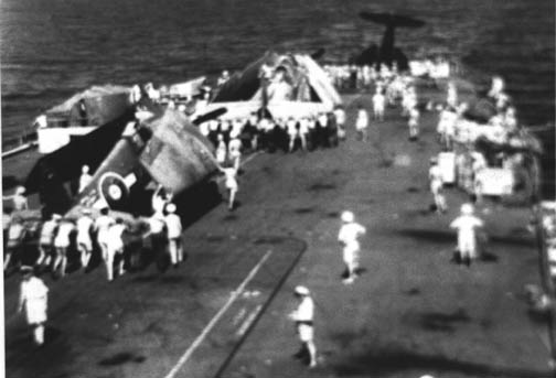

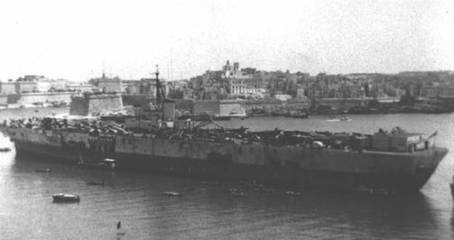

 Post subject: just a reminder
PostPosted: Sun Oct 03, 2004 1:47 pm
http://www.warbirdinformationexchange.o ... ping-1.jpg
http://www.warbirdinformationexchange.o ... ping-2.jpg
