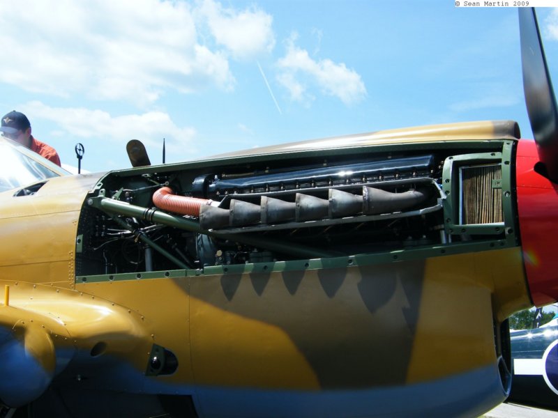

The early models had no filter. The later ones used a large filter alongside the nose. In this photo the filter is behind the perforations aft of the spinner.
In this photo you can see the side cowl removed, and the paper filter in place.
In the P-40s that used the Merlin, I don't know if they used a filter at all. The engine did not have a long service life on the P-40 -- maybe that's why. Some were re-engined later with the Allison again.
