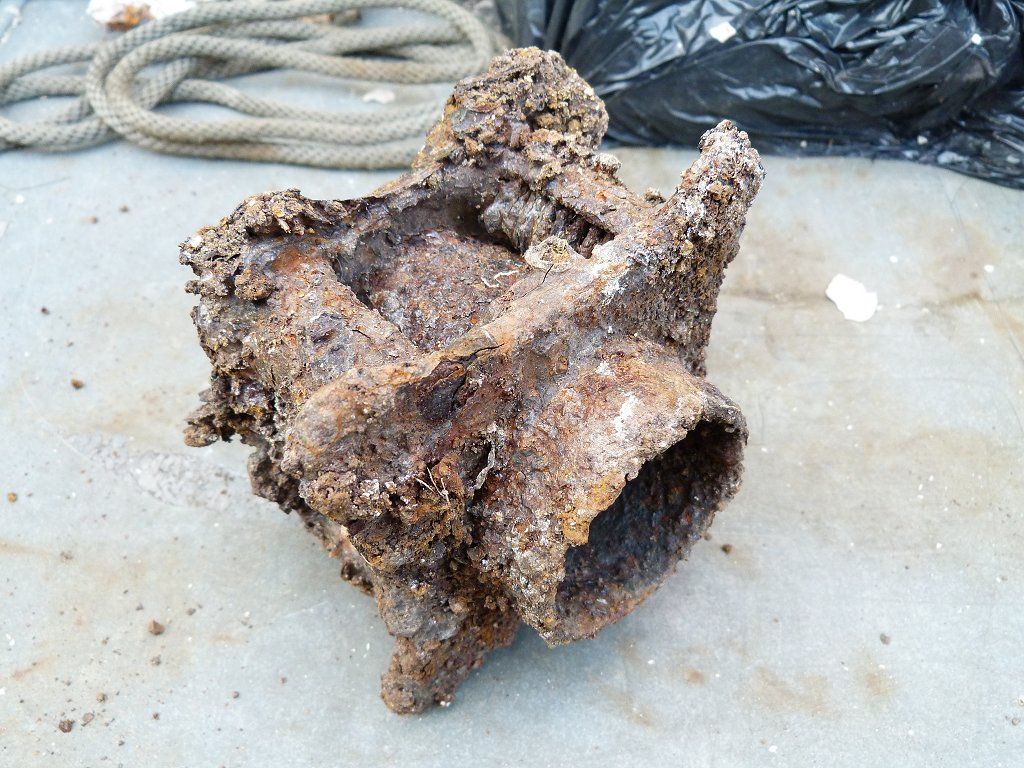

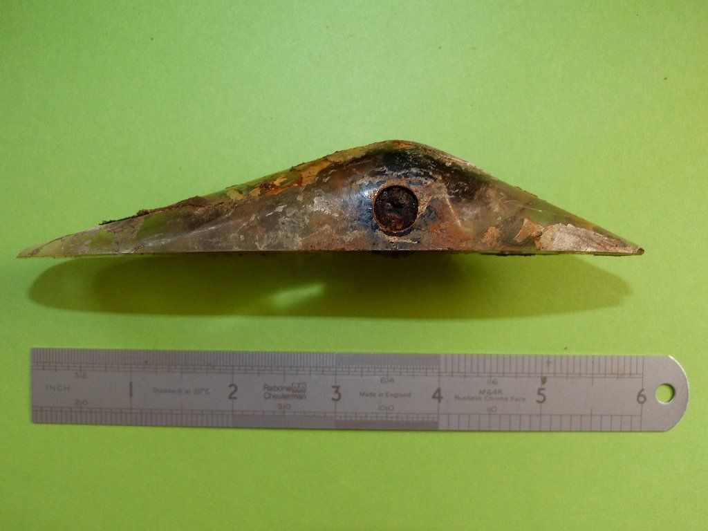

I picked this up at a former 8AF P-38/P-51 base today, looks like whatever it is was never fitted as it still has some of the packaging stuck to it.
Any ideas anyone?

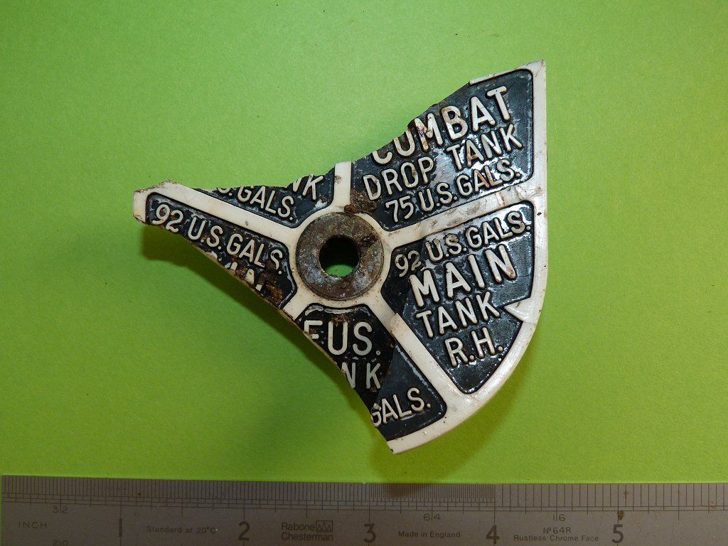

This flare pistol mount and P-51 fuel selector placard came out of the same hole:

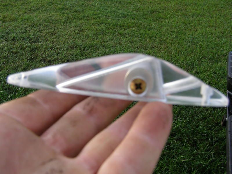

Cool items! The mystery part is also Mustang related - it is an antenna wire guide/pulley that was mounted to the canopies of P-51D/K's. The beacon receiver antenna wire passed through the canopy, through this clear fairing (with a pulley inside), and back to the tail. In most cases these antenna wires were removed once the aircraft was in its Theatre of operation, as there was no longer a use for the beacon receivers outside of the U.S. The pulley/guide fairings were also then removed and often an oval-like flat piece of plexi or other material was screwed into place over the hole in the canopy.
Photo by Glenn Wegman:

All 3 might be P-51.
Glenn already IDed tha canopy part.

The broken placard is the P-51 fuel selector bracket with the writing for the fuel tanks you'd select.
Duh, missed the line on the others.

Mon May 19, 2014 6:38 am
Thanks guys. :)
I had a feeling it was the antenna pass-through fairing, but didn't have the appropriate manuals handy to check. ;)
