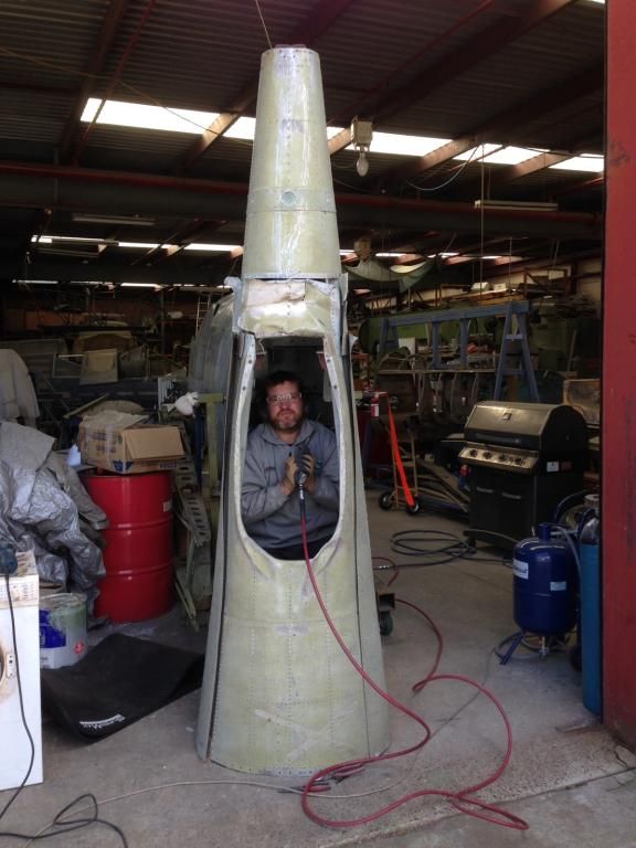

Brad looks very happy to be inside the sternframe section. Derivetting away - this is the frame from A9-13

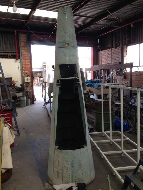

One of the other sternframes used for various parts and / or patterns A9-574

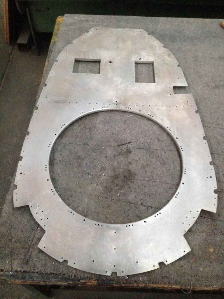

Done a test soda blast on a bulkhead from the frame - came up very well, just required some acid washing prior to dipping in alodine to get the last bits of corrosion out.

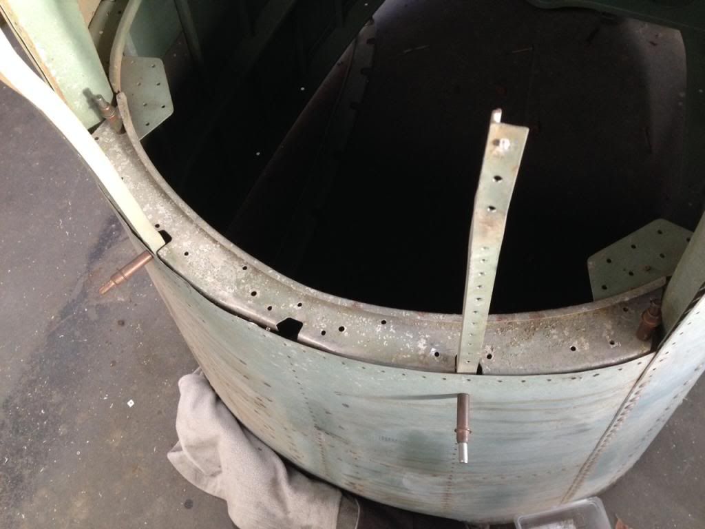

Finally - here is one of many challenges - you can see it's pretty corroded here. And the same issue is present in all three sternframes the Museum owns. So a decision is made to manufacture a replacement for this section rather than preserve what is there - it will ensure the aircraft's longevity.

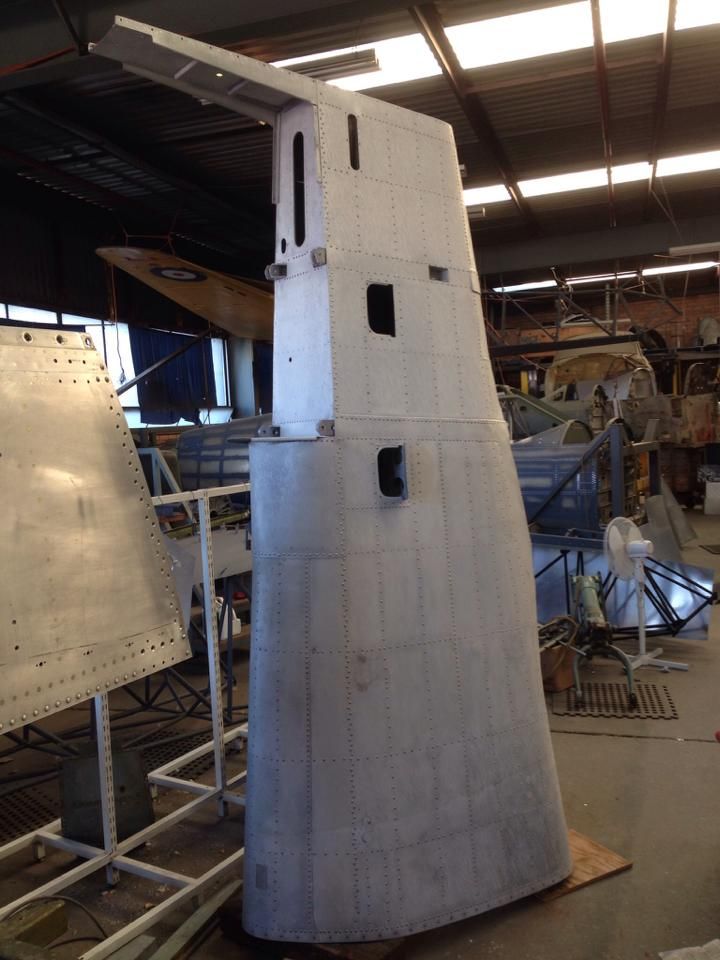

Presenting ............ RAAF Beaufort A9-13 Sternframe back from the blasters
