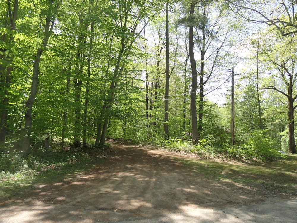

1. The end of the driveway. The old owner did live remotely. This was recovered near the Oswego River, north of Syracuse NY.
http://www.forgottenfield.com/amg/proje ... oCG-4A.JPG

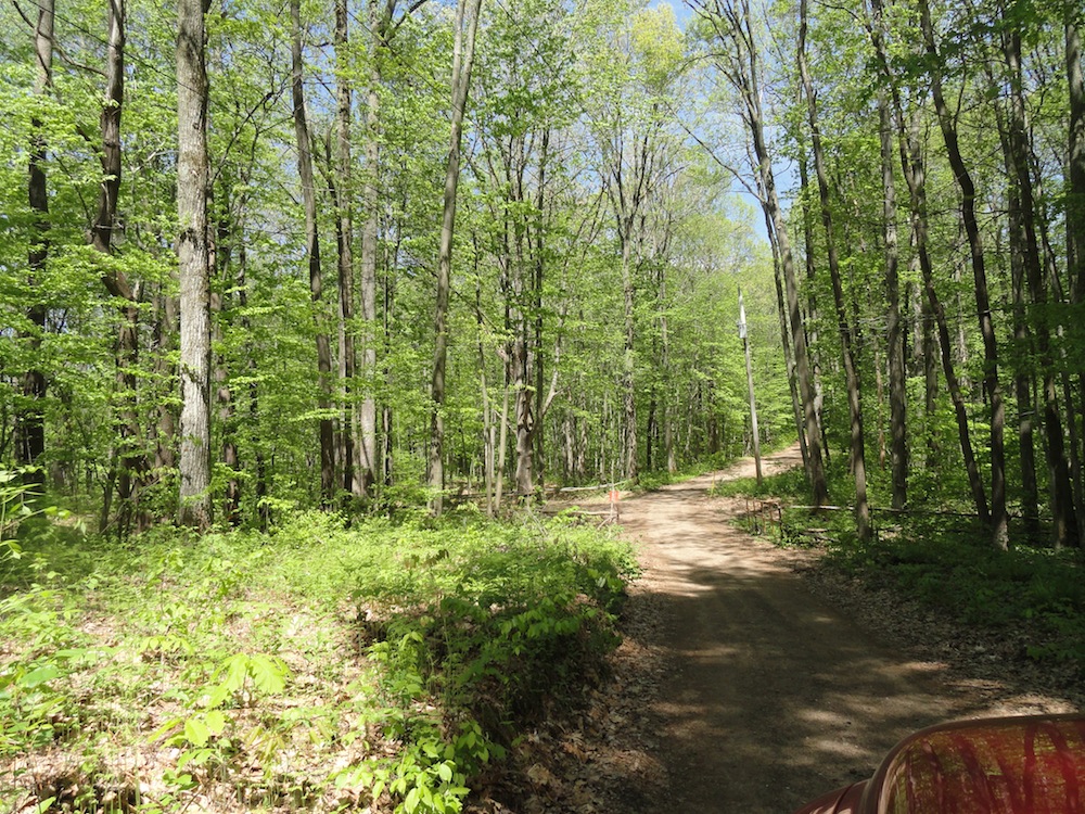

2. Driving down the driveway:
http://www.forgottenfield.com/amg/proje ... CG-4Aa.JPG

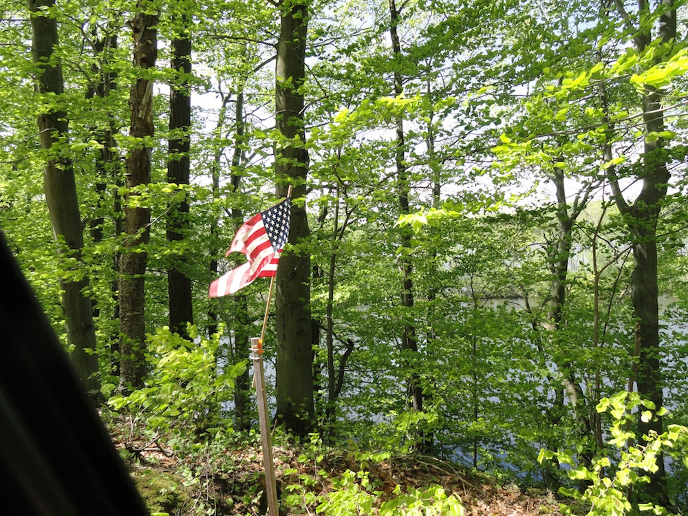

3. The Oswego River in the background.
http://www.forgottenfield.com/amg/proje ... CG-4Ab.JPG

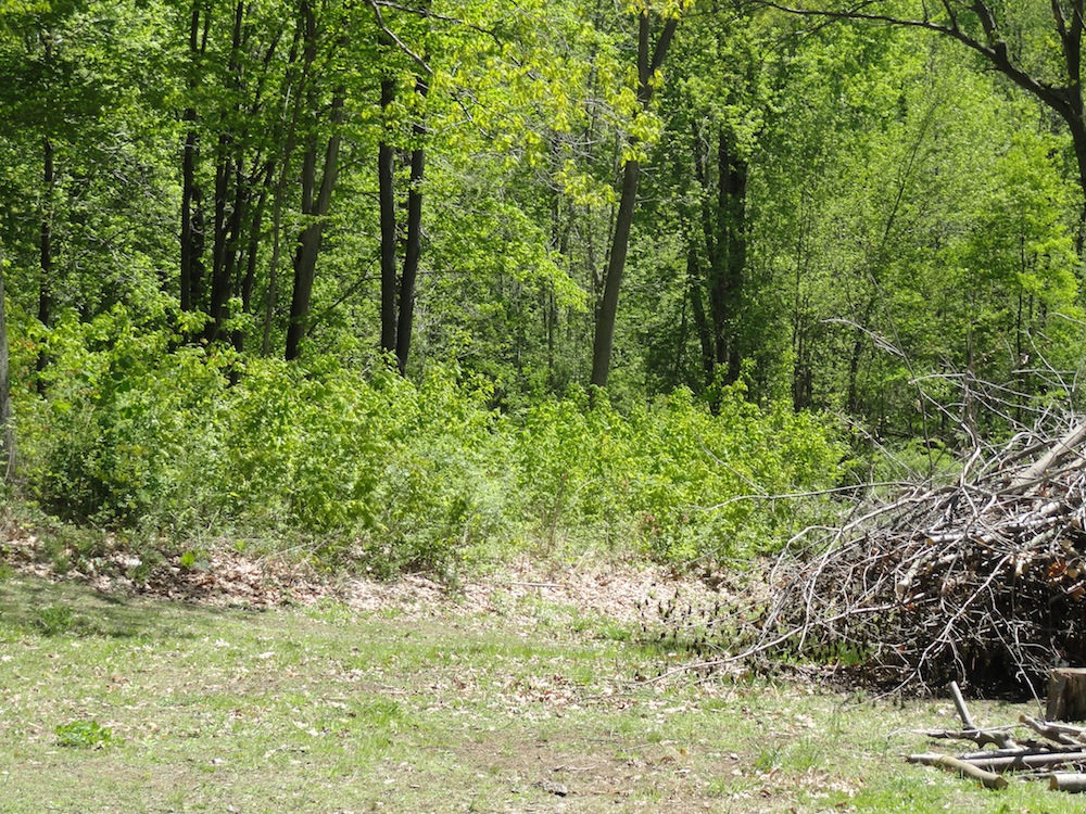

4. Where this cockpit (and the rest of the glider) used to lay when the old owner was a kid.

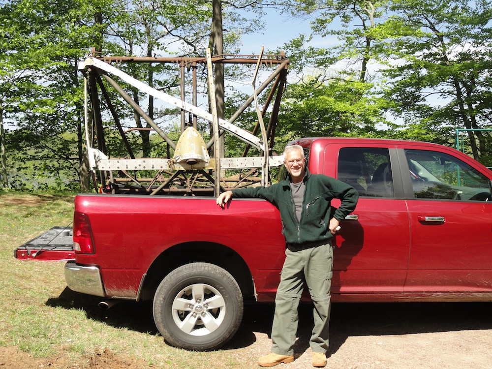

5. Loaded in my rental truck. The old owner standing next to it. It fit just perfectly in a Ram 1500. The rental place was going to give me another truck with a shorter bed. I would have had to ride with the tailgate open.
http://www.forgottenfield.com/amg/proje ... CG-4Ad.JPG

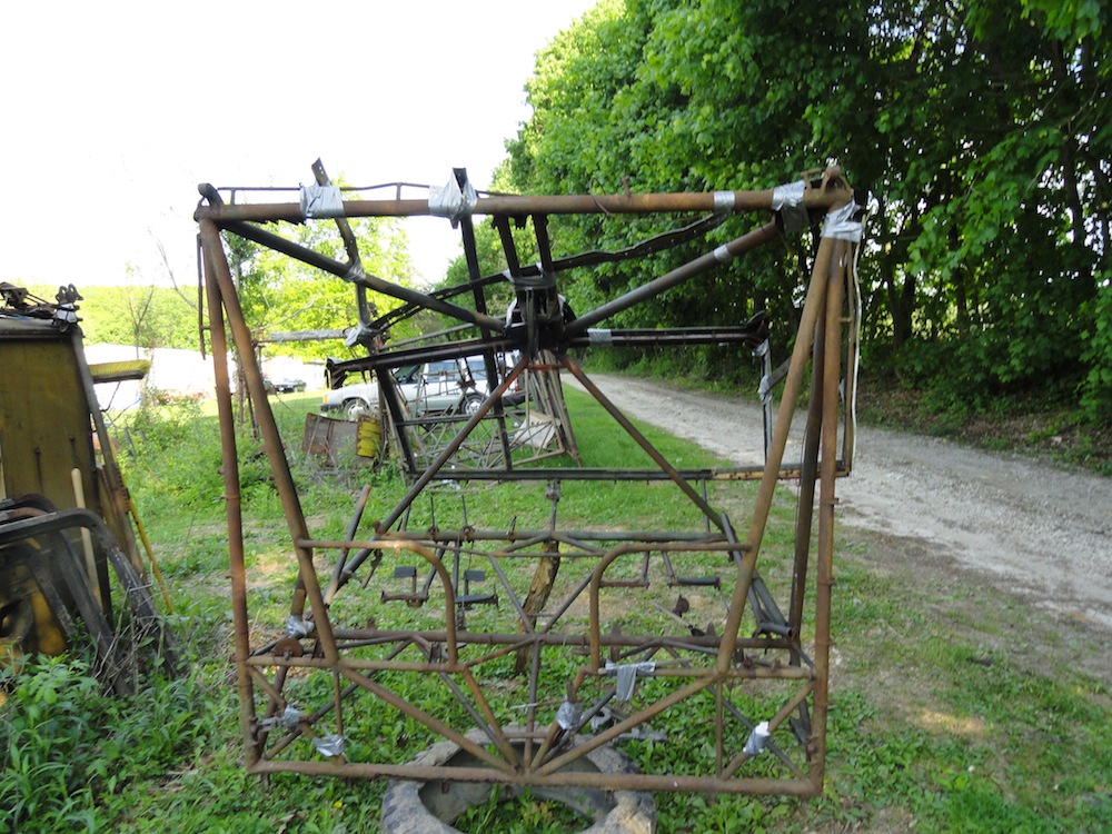

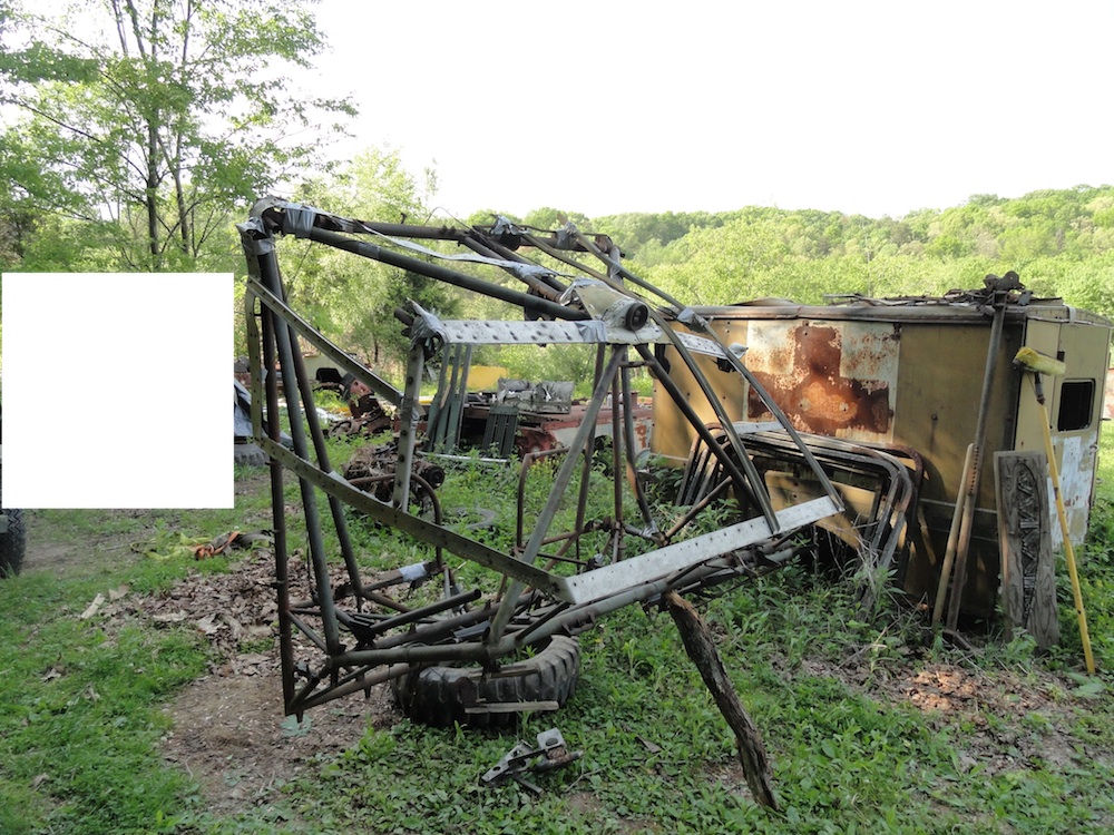

6. The glider home, taken this evening. Right front 3/4 view.
http://www.forgottenfield.com/amg/proje ... CG-4Ae.JPG

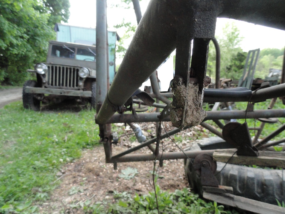

7. View standing where the main cabin section (where the troops or cargo went) looking into the cockpit.
http://www.forgottenfield.com/amg/proje ... CG-4Af.JPG

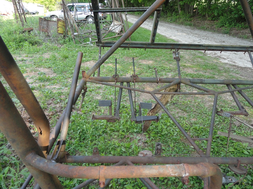

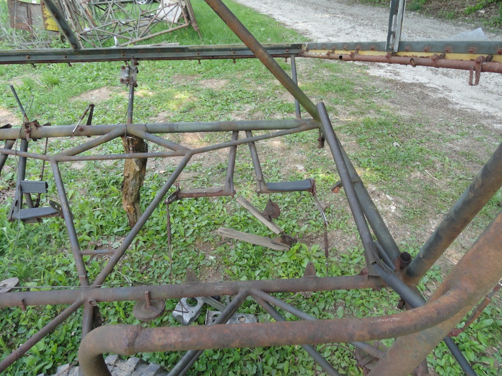

8. Looking over the Pilot's seat. The pilot was the only one with brakes. The large bar to the left is the spoiler bar; spoilers raise above the top of the wing and disrupt airflow to decrease lift, dropping the aircraft into a steeper glide when applied.
http://www.forgottenfield.com/amg/proje ... CG-4Ag.JPG

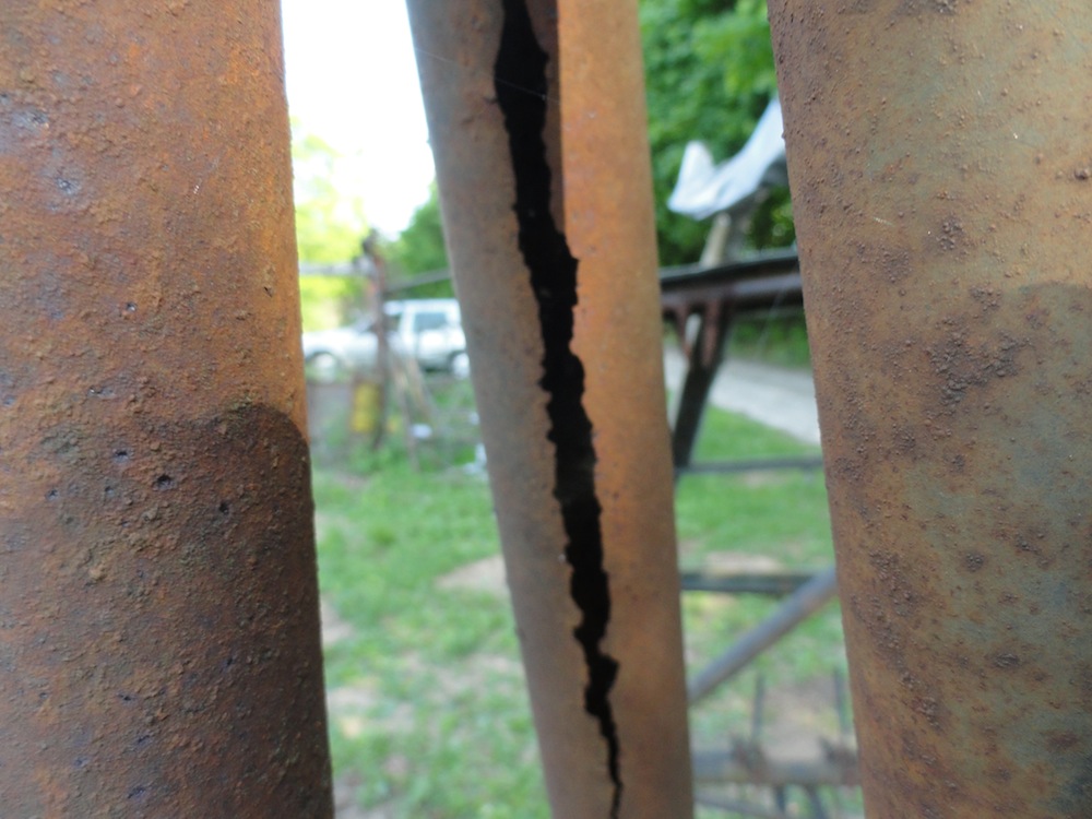

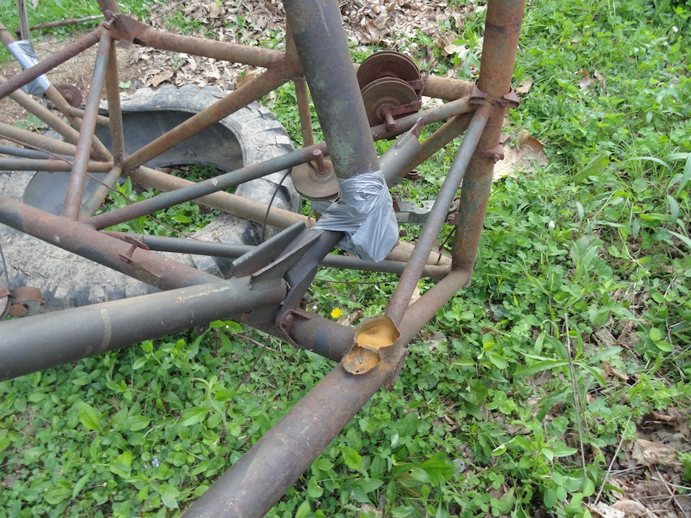

9. Some of the tubing splitting from being filled with water and freezing.
http://www.forgottenfield.com/amg/proje ... CG-4Ah.JPG

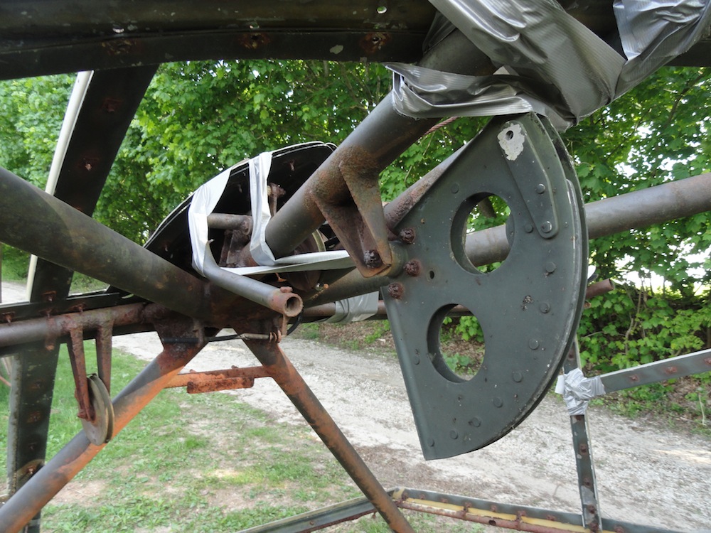

10. Some important items. The quadrant is for the control column elevator cable attach. The control column mounts here, and looks like an inverted V. The handle center left in the photo with the open end is the tow release handle. Pull that, and it's the moment of truth flying one of these things!
http://www.forgottenfield.com/amg/proje ... CG-4Ai.JPG

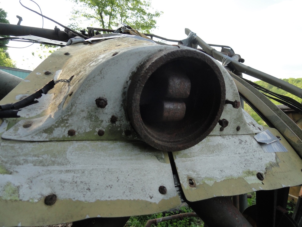

12. The tow release jaws and fairing. The jaws are like a set of square-nose pliers. They split apart when pulled against. The release pulls back a spring-loaded collet which allows them to split and release the tow rope. This set-up is used on the glider and the tow aircraft.
http://www.forgottenfield.com/amg/proje ... CG-4Ak.JPG

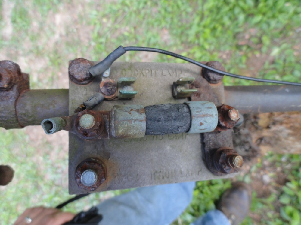

13. The cockpit electrical junction block. I believe this is an earlier glider, equipped with recognition lights, and cockpit and landing lamp only. I believe later ones had a pitot-tube heater and eliminated the recognition lights.
http://www.forgottenfield.com/amg/proje ... CG-4Al.JPG

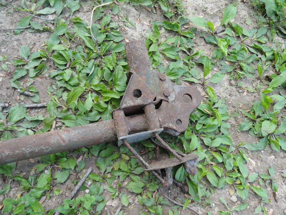

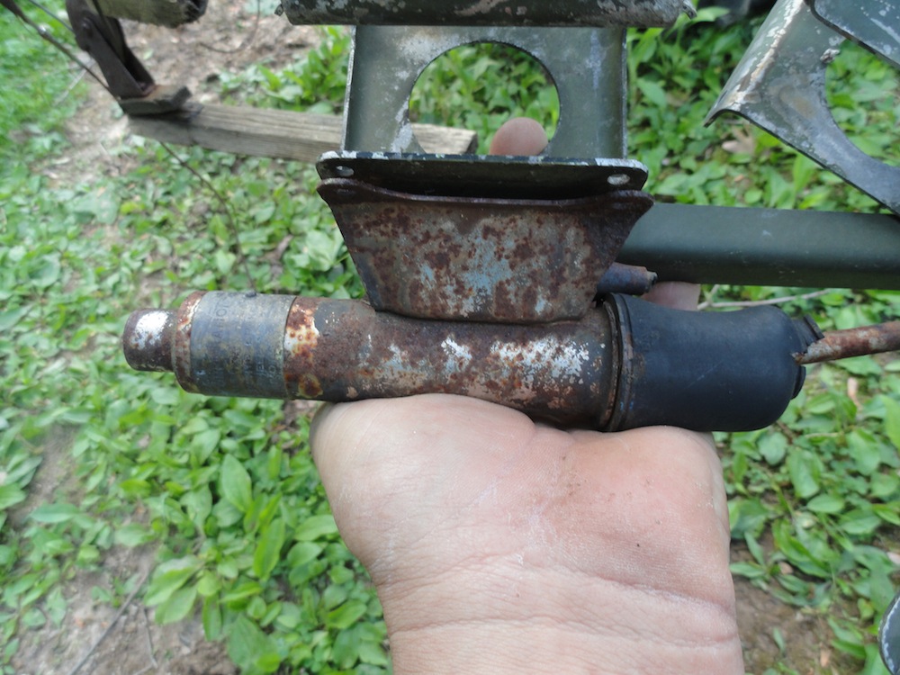

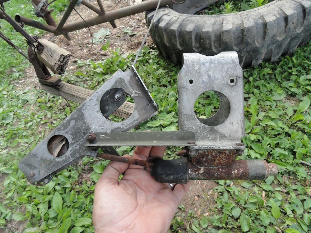

15. Below was a piece from behind the cockpit in the main cabin section. It is the main landing gear brake master cylinder and the bracket which attaches it to the fuselage tubing. There is a bellcrank which is pulled, levering the master cylinder. There are two, one for each main landing gear. The master cylinder was made by the Warner Electric Brake Company.
http://www.forgottenfield.com/amg/proje ... CG-4An.JPG
http://www.forgottenfield.com/amg/proje ... CG-4Ao.JPG

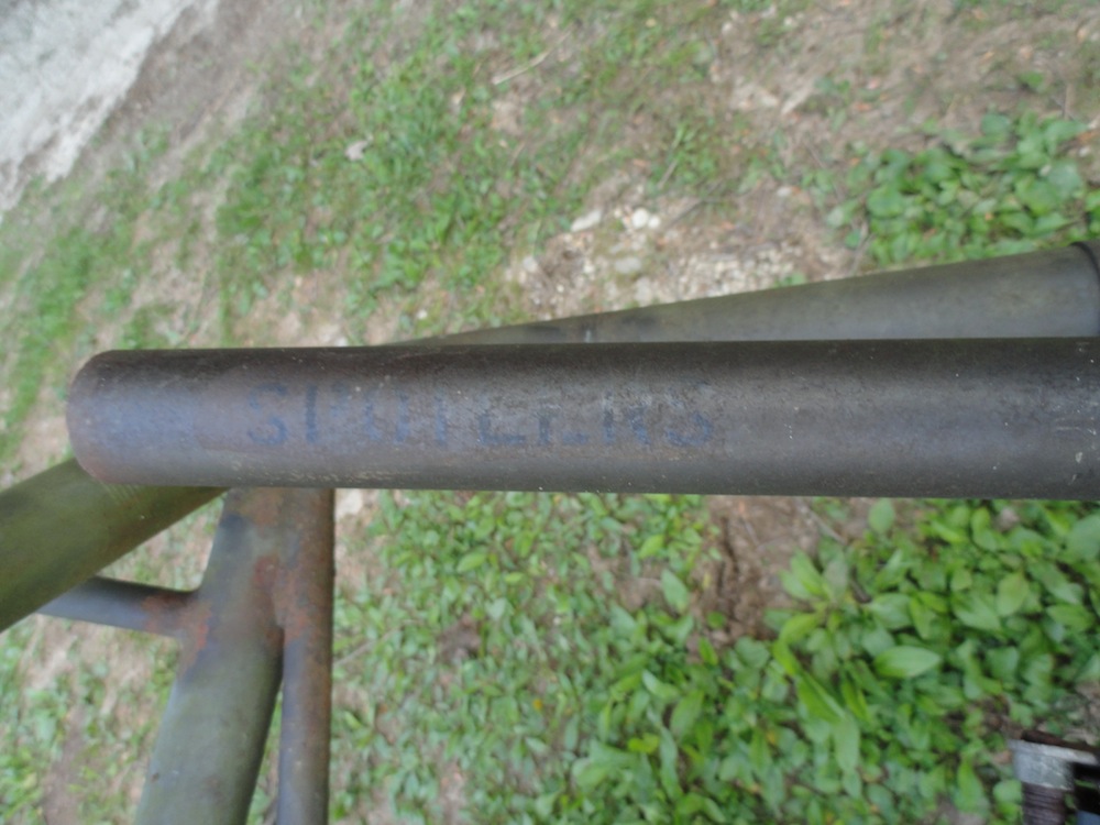

17. Placarding on the Spoiler Handle.
http://www.forgottenfield.com/amg/proje ... CG-4Aq.JPG

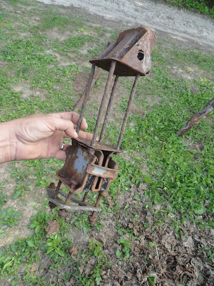

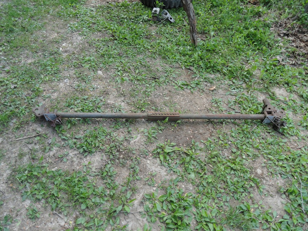

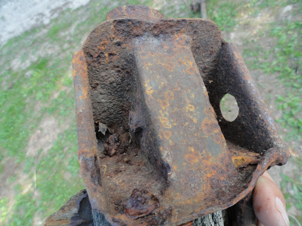

18. The main cabin section carry-through for the main landing gear. The ends are tabs which the strut attaches to. The long bolts on the end go through the main cabin section floor, which is also made of wood.
http://www.forgottenfield.com/amg/proje ... CG-4Ar.JPG
http://www.forgottenfield.com/amg/proje ... CG-4As.JPG

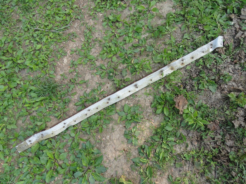

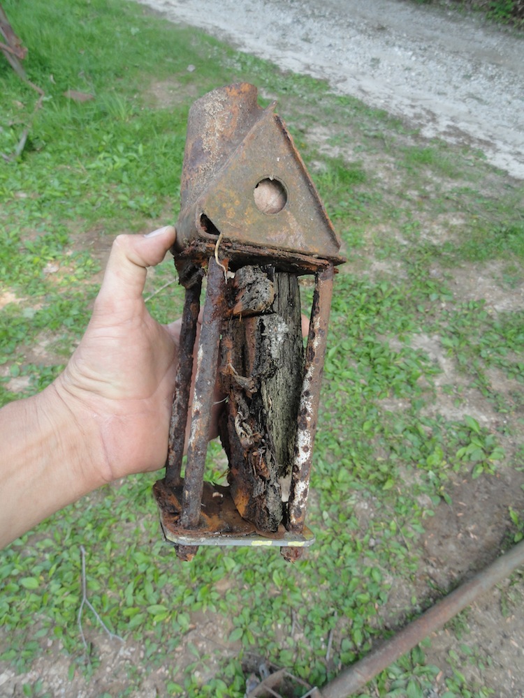

19. Sections of the main cabin section tubing with piece of the floor spar.
http://www.forgottenfield.com/amg/proje ... CG-4At.JPG
http://www.forgottenfield.com/amg/proje ... CG-4Au.JPG
http://www.forgottenfield.com/amg/proje ... CG-4Av.JPG

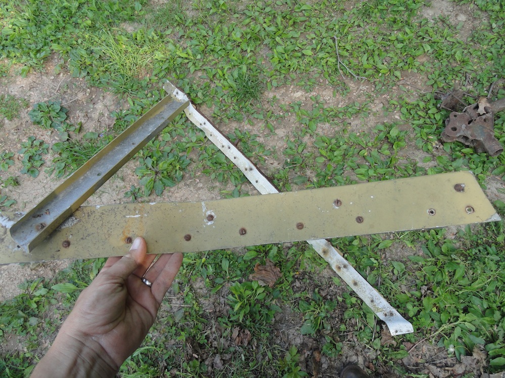

20. Some of the cockpit canopy enclosure framework.
http://www.forgottenfield.com/amg/proje ... CG-4Aw.JPG
http://www.forgottenfield.com/amg/proje ... CG-4Ax.JPG

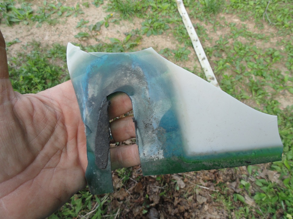

21. Piece of the upper canopy plexiglass, which was shaded green.
http://www.forgottenfield.com/amg/proje ... CG-4Ay.JPG

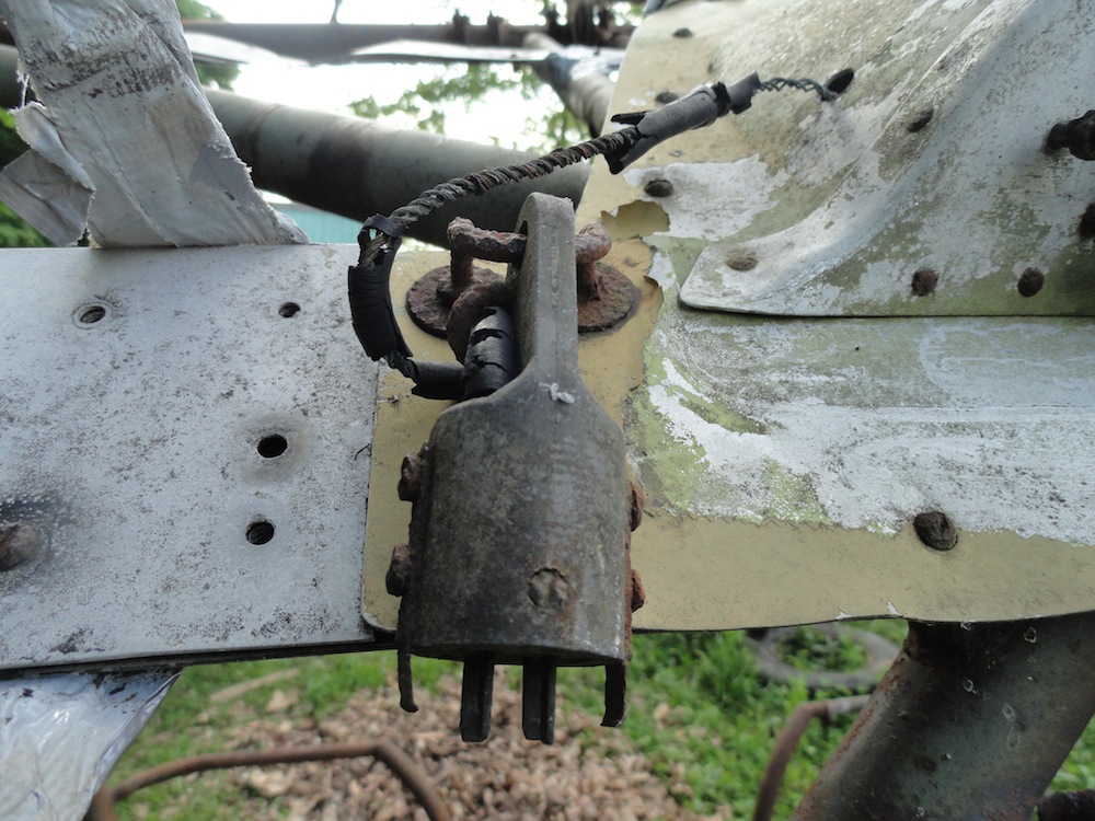

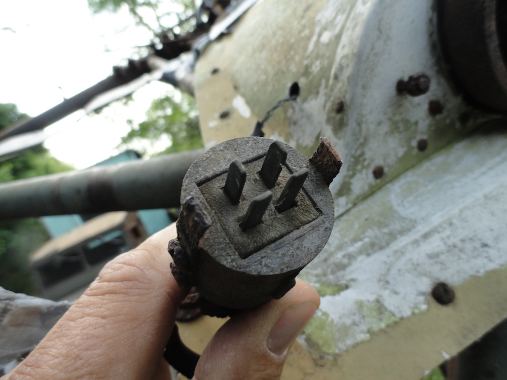

22. The connector for the intercom system between the tow-plane and the glider. It's in pretty good shape.
http://www.forgottenfield.com/amg/proje ... CG-4Az.JPG
http://www.forgottenfield.com/amg/proje ... G-4Aaa.JPG
