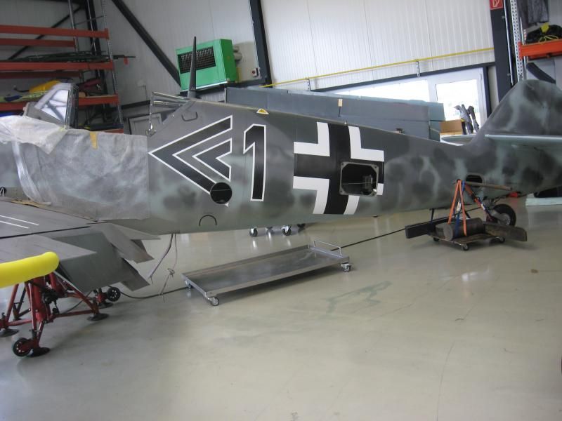

Marine air: Cockpit will be 100 % original G-12 style, both fromt and rear seat canopy opening to the right, no sliding canopy. Different to single seater 109 canopies the 2- seater ones are not hinged at the lower right side, but on the upper right side (I´d guess for stability reasons). You can see the cockpit construction on MeierMotors homepage, click the link and scroll down a bit.
http://www.meiermotors.com/index.php/pr ... l=&start=1

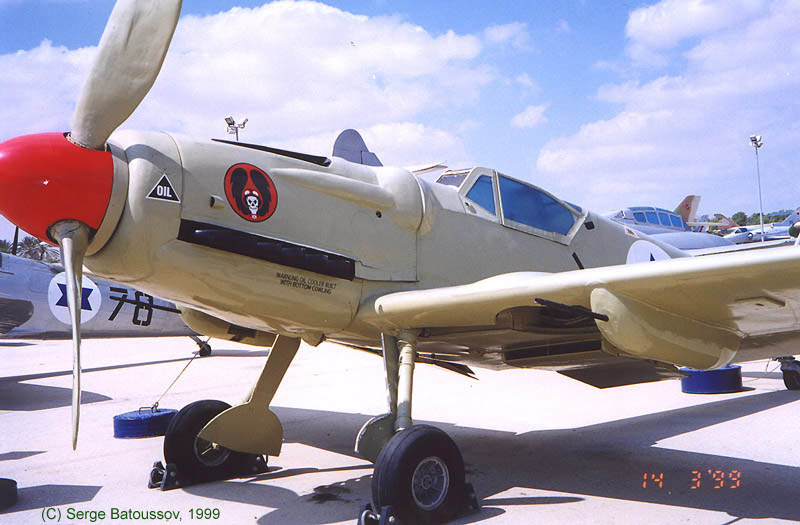

Personally if it were my plane, I would have gone for the late Avia CS-199 style canopy, but who am I?
http://www.modelarovo.cz/avia-s-199-a-c ... ast-prvni/
There are pics of the single seater S-199 and 2-seater CS-199 Avia, Prague-Kbely museum, in fact a 109 with different engine (Jumo 211),and some modificationss, interestingly the (late) S-199 has a blown sliding canopy (I´d asume they used up the stocks of original canopies, when there weren´t any left, they used the ones seen). Both a/c are of the late versions, early Avias were Bf-109 G-10 or G-14 without mods. Main difference was that the 199´s used Jumo´s (most DB 605´s were lost due to fire in the storage facility), the S and CS-99 used DB 605.
Michael
Yagens 109 (my pics):

That's a great looking restoration. Speaking of Buchons, I cringe when I see them in "The Battle of Britain". -Joe

Nice page onthe two seat conversion. Nice! I also like how the Avia has a drop tank to help add range since the fuselage tank is removed for the second cockpit. I think this would be a welcome addition. I would also consider oxygen, cockpit heat, and relief tubes re-installed as the fewer landings made away from home base the smaller chance of tearing the aircraft up.

I like the way Avia modified the angle of the wheel shaft angle on the landing gear to improve ground stability.....hence the bulge on the top of the wing for the wheel when in retract position.

Most G-12´s usually had a 300 liter droptank as well (G-12 R3), though were flown with and without. I doubt it will be possible to use a droptank on this one, AFAIK droptanks are only allowed for military a/c in Germany. A fixed one might be possible, but quite dangerous in case of a bellylanding.
