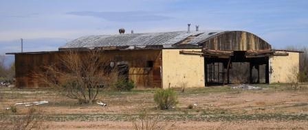

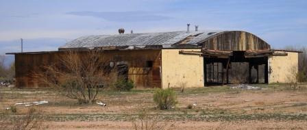

One WWII hangar is still standing barely...

That's not a hangar per se, it's a maintenance shop, probably motor pool as well. the posts are too close together, and it has a grease pit. And bees. lots of bees.
The whole area was slated to be razed and turned into an industrial park. I have not made it there in a few years
https://plus.google.com/photos/11346120 ... 6051789841

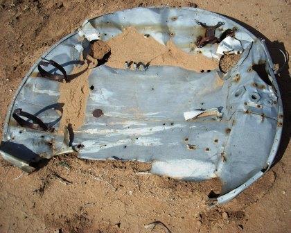

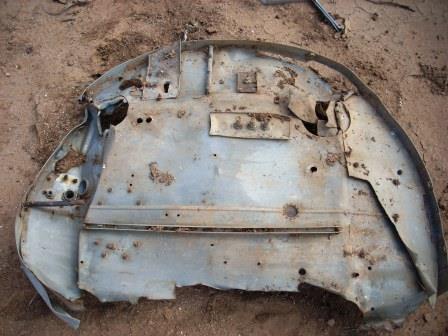

I discovered a few aircraft parts out there, but I never did figure out what aircraft this came from. Any body know?
