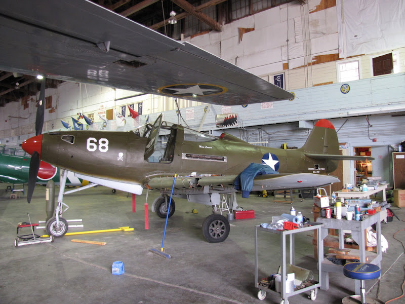

While ferrying a Cherokee today I had some time to stop by the Den and got a very nice tour of the place. Here are a few of the "warbird" photos.
The P-63 was receiving some last minute TLC from Ray to make sure the landing gear are in great condition.
The P-39 is still in need of skilled sheetwork to finish up. They have some, but it's a matter of the time that those people have.

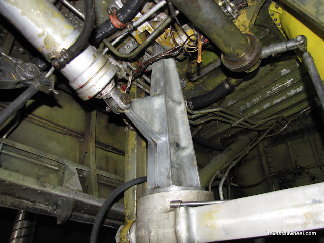

For those of you not in the B-25 loop - here's the offending part that has caused the B-25 fleet trouble of late.
It's the part on top of the pivot point on the main landing gear, and is a piece that absorbs a lot of the shock of the landing. Apparently about 50% of the fleet so far have found that they have cracks as well. The good thing is that the Yellow Rose crew seemed pretty optimistic that as soon as they have the replacement parts, they will be able to fly in a matter of days if all goes well.
First the big picture:
Now up close...
And a mechanic is pointing out to me where one of the cracks was found...
One more shot for the super-detail modeller types out there...
Both sides will need the fix on the Rose.
