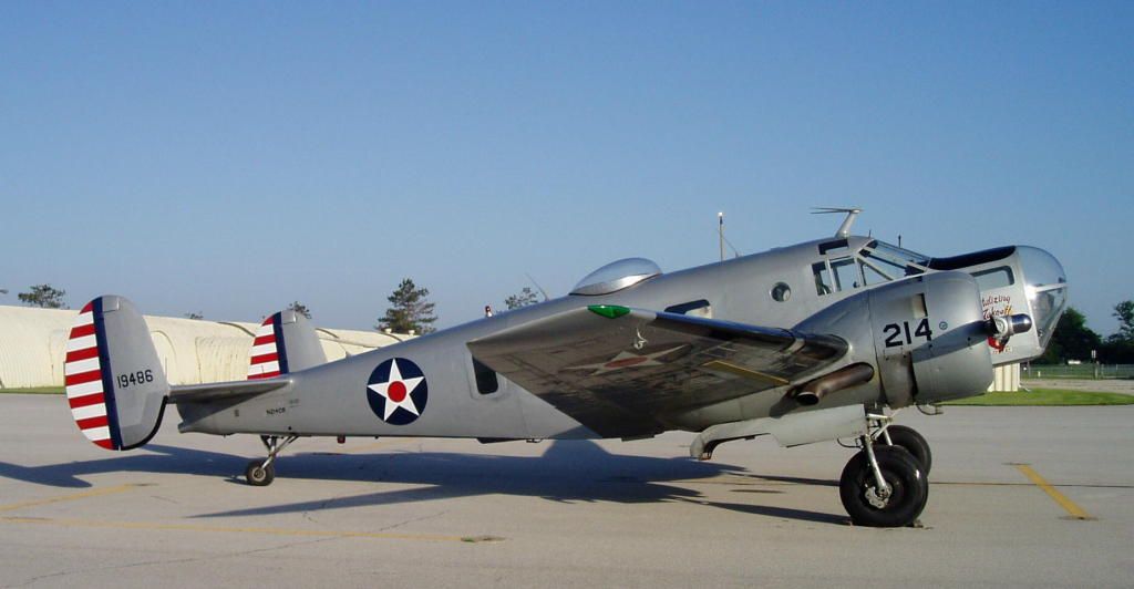

my wife and I have owned a Beech E18-S for several years and really enjoyed it. The only void was that it never had any real historical significance. We wanted something that would be honoring Veterans, preserving history, and educating the next generation. Fran and I sold our E-18 (and RV-4) and bought Mark and Celia Godsil's very nice AT-11. It is a 1941 built Kansan that spent the entire war training bombardiers and gunners in Victorville. It was surely flown by WASP too as they were based at VCV and flew AT-11's there. Unfortunately there are only 5 WASP left that flew out of VCV, we are trying to find out if any might remember 41-9486.

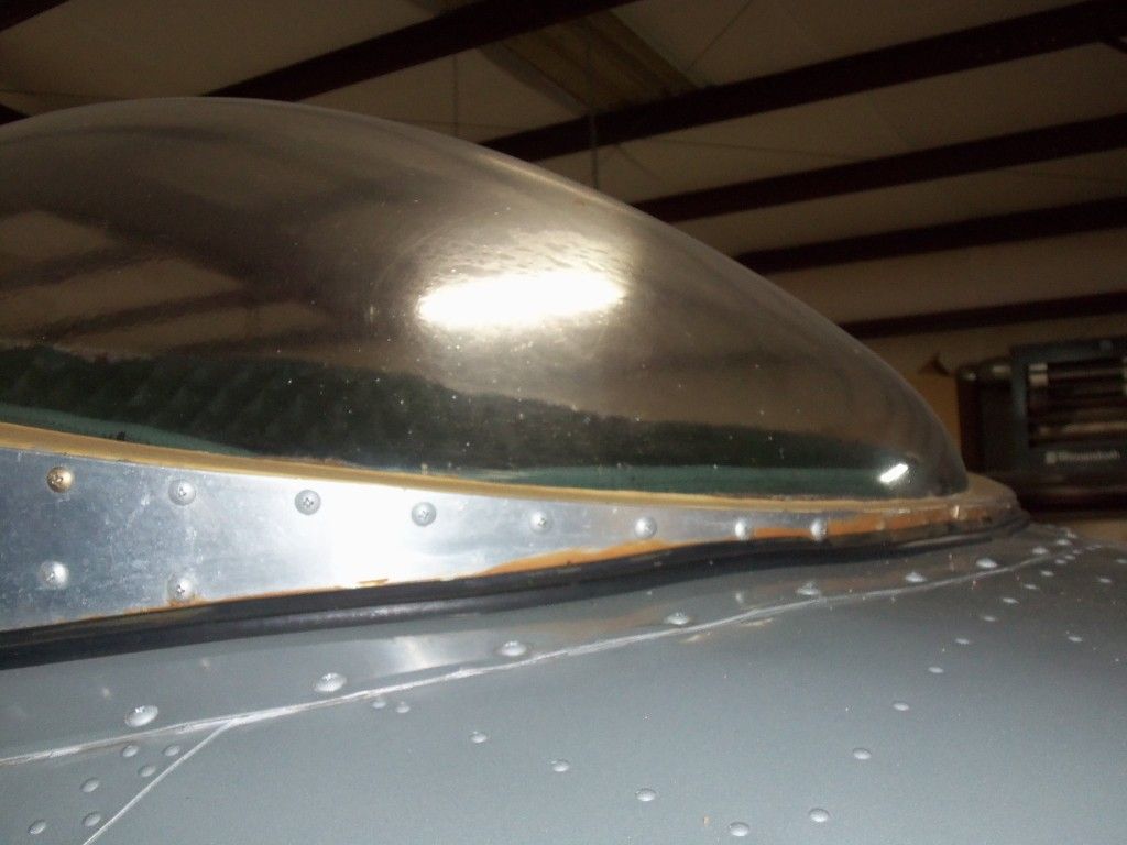

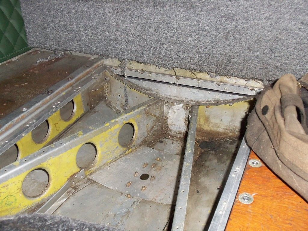

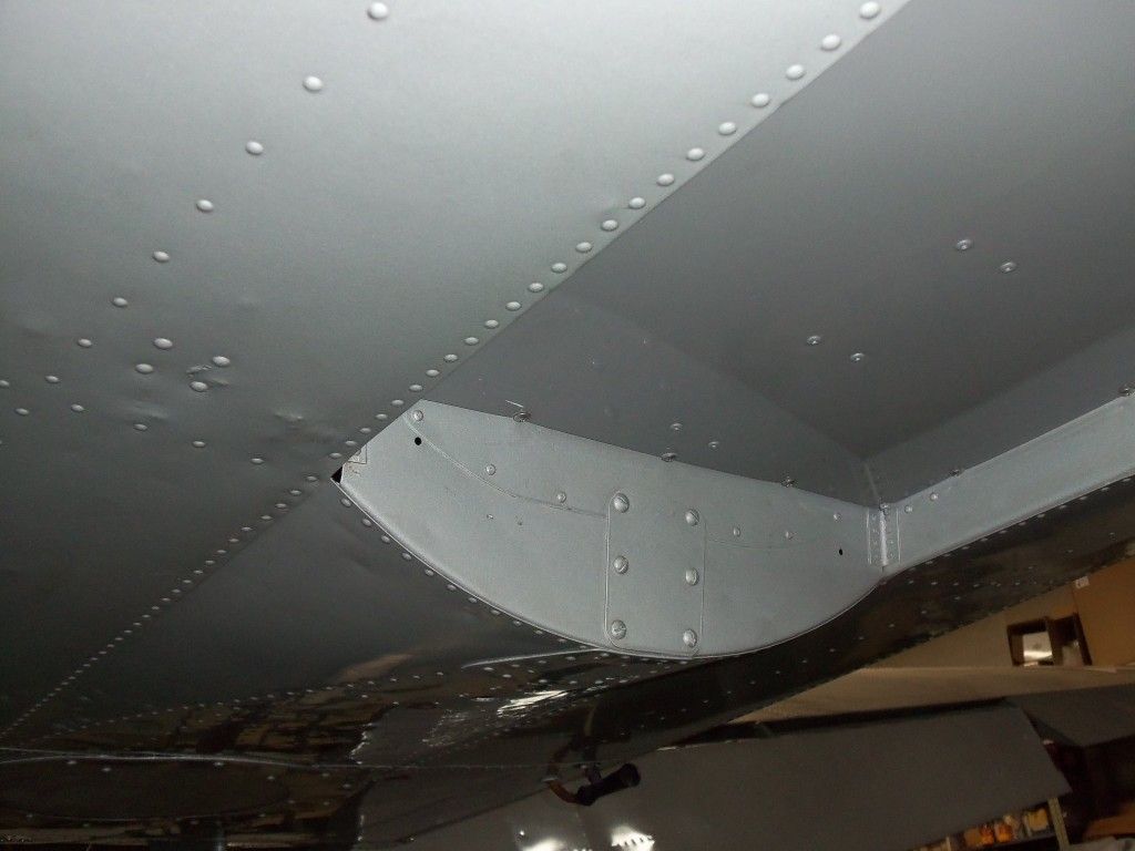

This was the 49th Kansan built so it had the early Beech turret (that looks like a large teardrop navigator dome). It has a nice looking fixed plexiglass turret, and still has the original tunnel gun position, but no guns. It would have had 1 ANM2 on the top turret and one ANM2 in the bottom.

I hear Steve Smith has a good kit for making sim-fire guns but I'm not sure an ANM2 can be done because of it's smaller size. Has anyone even seen a gas fired ANM2 and did it work very well? I'll load some pictures of the areas the guns would have mounted and hopefully someone can lead us in the right direction for the mount type, or good ideas?

This AT-11 is one of two that have been modified to a gross wt of 9465# with the addition of square tips, D-18 ldg gear metalized controls, and a couple of other mods. I would rather be more original but I like the (430 gal) long range tanks. (It was a survey aircraft after the war).
Fixed replica turret
Cover plate on the tunnel gun hole.
The original tunnel gun mounting area.

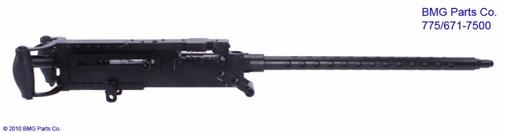

Hi Stoney, I talked to Stephen at IRAC and he doesn't build ANM2 replicas any more. He said it was such a low demand gun. He was skeptical that a .30 cal ANM2 could be made into a sim fire, said there would have to be 10 pounds of s#!* in a 5 pound bag.
I'm presently looking at 2 sources for the ANM2
Guns of Liberty's replica:
http://www.gunsofliberty.com/gol_anm2.htm
And BMG:
http://www.bmgparts.com/anm2.html
These are both mostly aluminum replicas so they only weigh 17-20 pounds
Neither offers a Sim-Fire option, it would have to be done as a kit, (if even possible).

The Mark 9 mount is a good one to use as it it about as close as you can get for the money. The original mount is super rare and 9999 out of 1000 air show patrons will not know the difference anyway. You will need two one for the turret and one for the tunnel gun as they were the same and mount similarly. They even use the same ammo box as what was used in the AT-11 and your Mk 9 mount comes with the ammo box mount.
The other impossible part to find is the casting to secure the gun mount to the airframe but you can fabricate a simple adapter that will work. I can do that for you if you like. It is basically a socket that the post on the yoke fits into.
