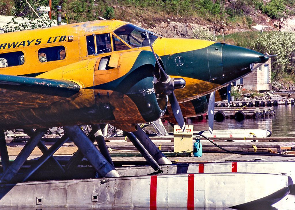

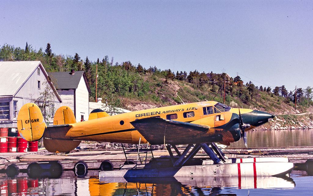

So is this an example of the pointed nose cone referred to in your post, b29driver?
Neal Nurmi
---Wingman Photo---
PostPosted: Wed Jul 15, 2015 6:54 pm
Joined: Wed Apr 18, 2007 11:37 am
Posts: 215
Location: Tx
Yes. Notice the short exhaust pipes, external intake scoop, modified cowling outlets and horizontal stabilizer flush with top of fuselage. Wing tips appear to be the extended factory type, I can't tell for sure from photo. The twin rudder trim tabs indicate a D-18 or a C-45 fitted with a D-18 tail. One piece windshield and filler door for "nostril" fuel tank.
Pitot tube is in nose bowl. I haven't seen that before, but I am guessing that is peculiar to the float planes to keep spray out of it.
Most likely a 9800# gross if it was on rollers. I am not authority on the float mods. :drink3:
PostPosted: Wed Jul 15, 2015 7:05 pm
Posts: 1095
Thank you -- I've wondered about that nose for over a decade. I've been told that this aircraft has since been sold and repainted, and that a more conventional nose has been fitted.
Good thing from my point of view, as I find this pointed nose quite unattractive...

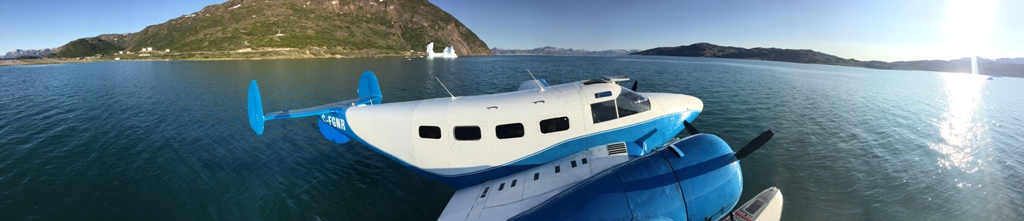

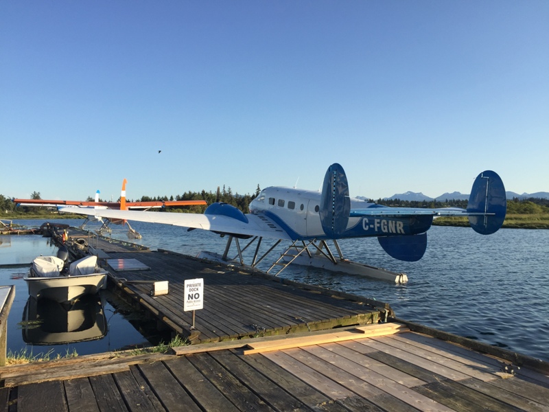

Very cool photos Neil. I just got back last night from flying GNR with Brad Blois from Campbell River, BC to Belgium via: Goose Bay, Greenland, Iceland and Scotland. Here is a photo of her with her current nose that looks a lot better than the one back in her Green Airways days:
At Campbell River, Vancouver BC
Moored in the fiord in Narsarsuaq, Greenland or Bluie West One, originally built as a WWII airfield for the aircraft crossing the Atlantic on their way to the European theater of operations.

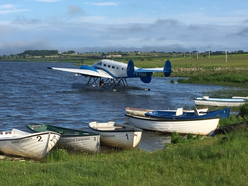

Loc Watten, Scotland

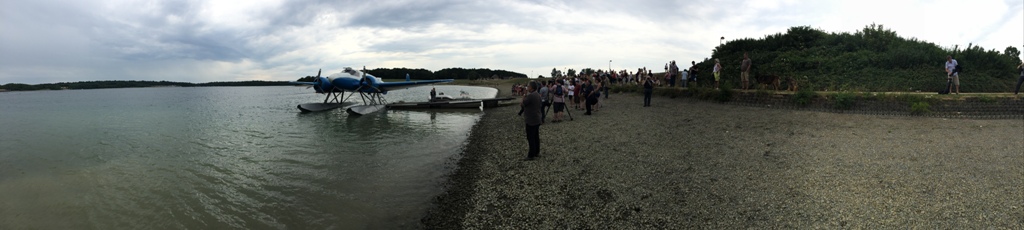

She was a big hit there and lots of people and all of the media turned out to welcome her. They said that this was the first time a sea plane had landed in Belgium. I find that hard to believe and maybe I misunderstood. Maybe it was the first to land on this particular lake. Bob Parmerter said it was the first time a Beech 18 on pure floats had crossed the Atlantic under her own power as the others were on the deck of a ship. Anyway it was quite the trip.
