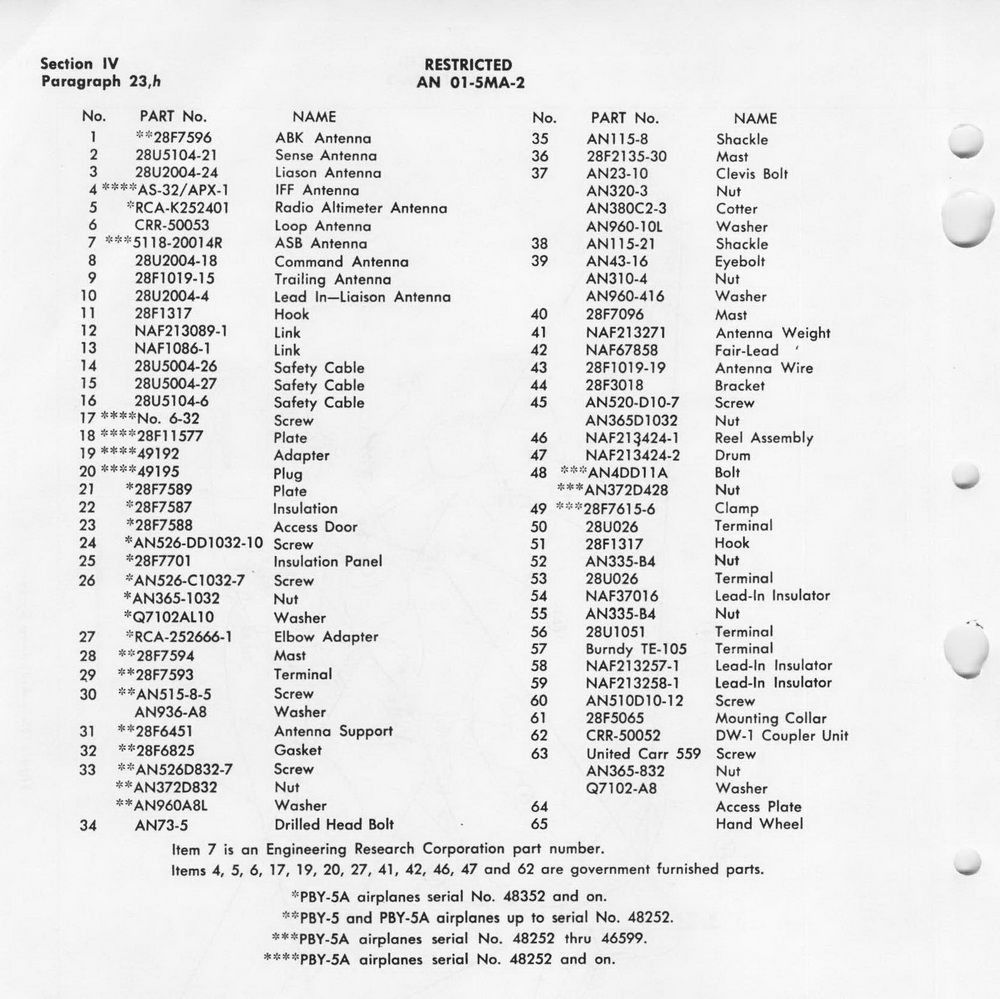

Yves, I would be interested in the key or legend to that diagram if you are able to share it.
Steve, below find the legend to the previous drawing. The first 10 positions are the antennas:
Both are copied from "Handbook of Erection and Maintenance Instructions - Catalina PBY-5 & PBY5-A" AN 01-5MA-2 from 15. May 1945
