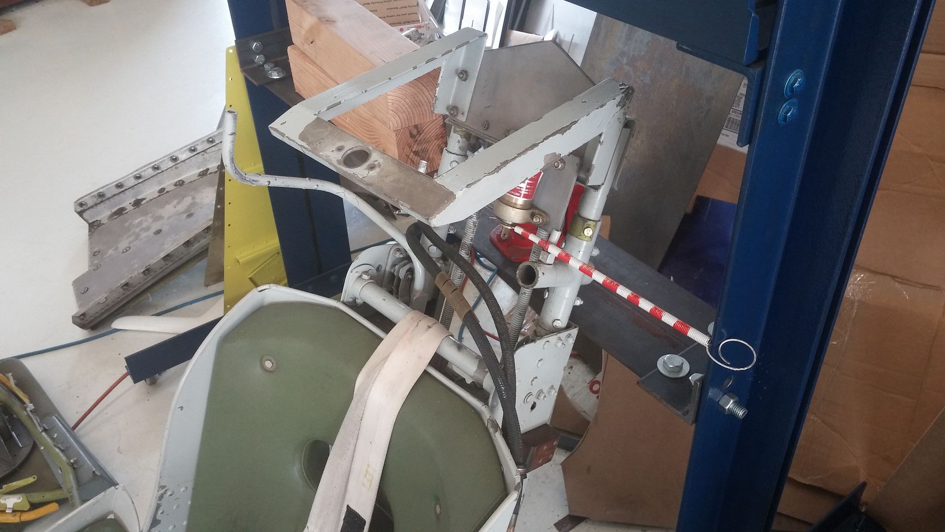

So WIX Brain, here is the challenge. There is a mod to the canopy breaker on F-86 Sabres that saw duty in South Africa (I think). The mod consists of an angle steel extension that holds a spring loaded mortar. Does anyone have any more information on this mod?
Here pictured in a group of SAAF Sabres. Ours was #381.

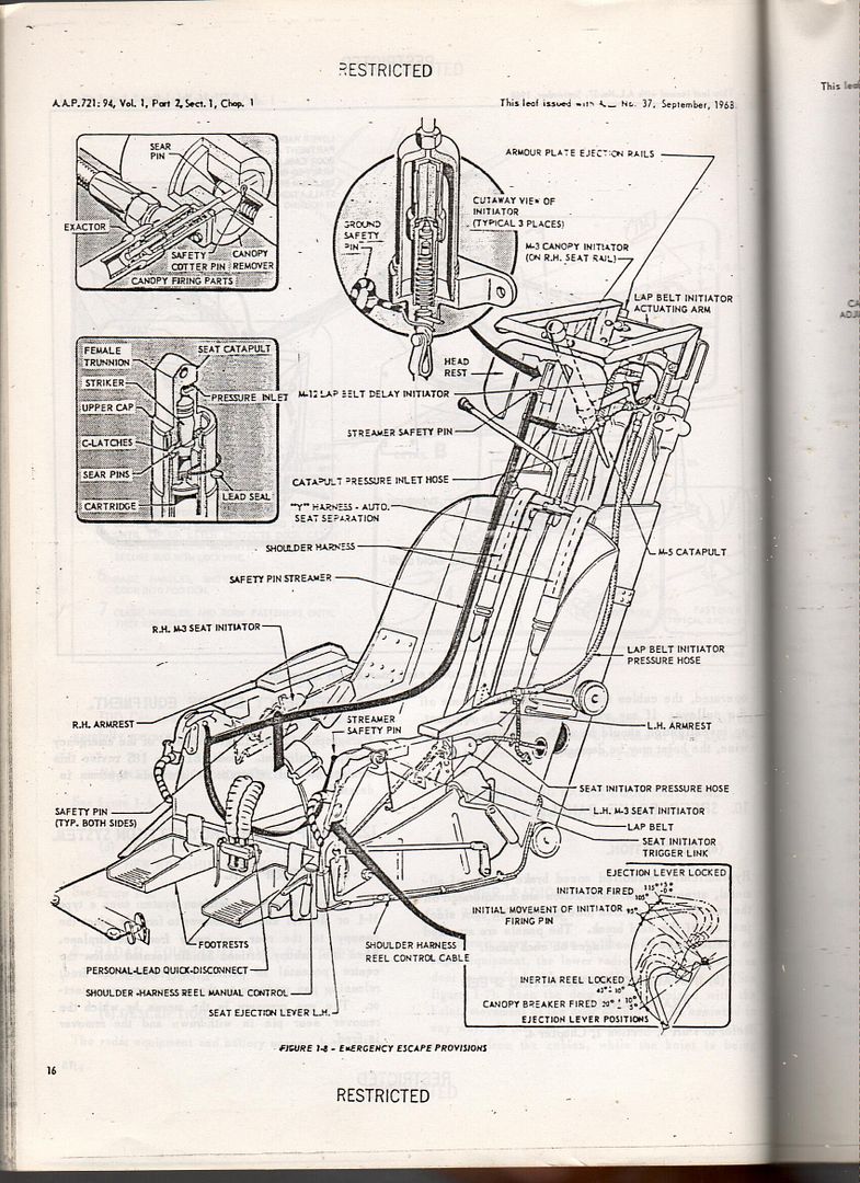

Here is something from the maint manual.
Challenge is, who can lead us to the mortar assembly with cables, etc.? Game on!
