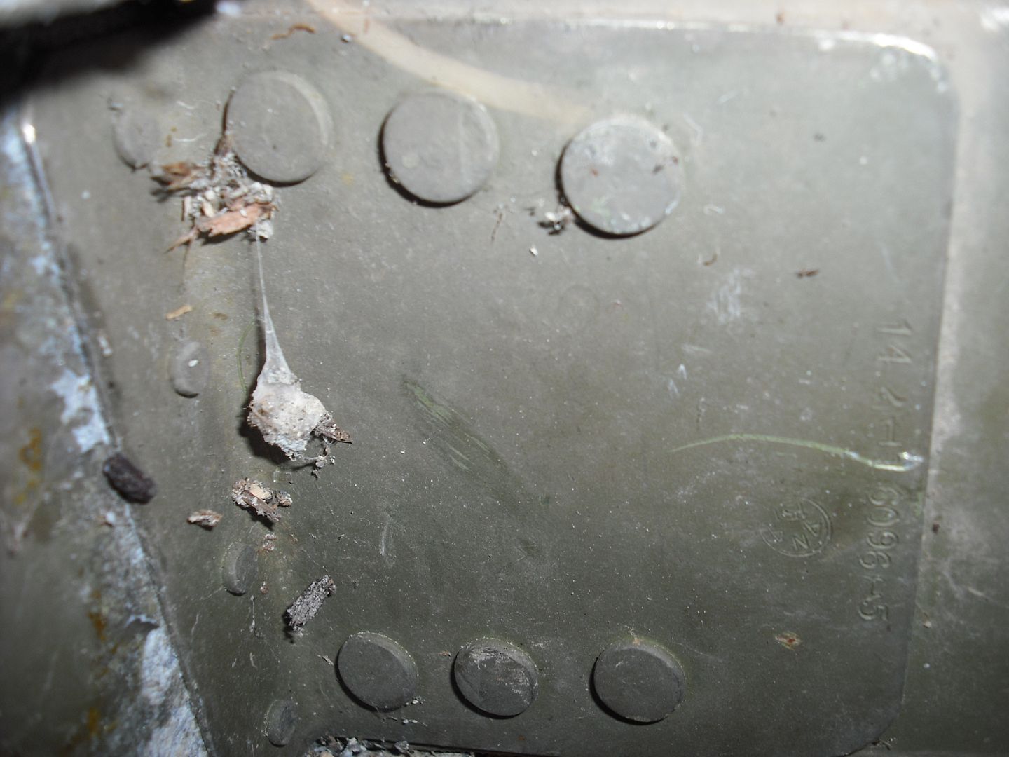

Fantastic work Van! I have been to that exact before a few years ago. I managed to get this photo with a serial number of what I believe is the same debris.
I really enjoyed my time down on the rocks- wish I had an excavator. :D Was really hoping for an Arado!
Shows the NAA stamp, with NAA 151, and the part number 144 1 6096 1 5. The 1's are horizontal.
Cool! Thanks!
Actually, if you look close at the part number in your photo it say 142-16096-5 not 144. :)
