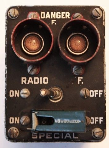

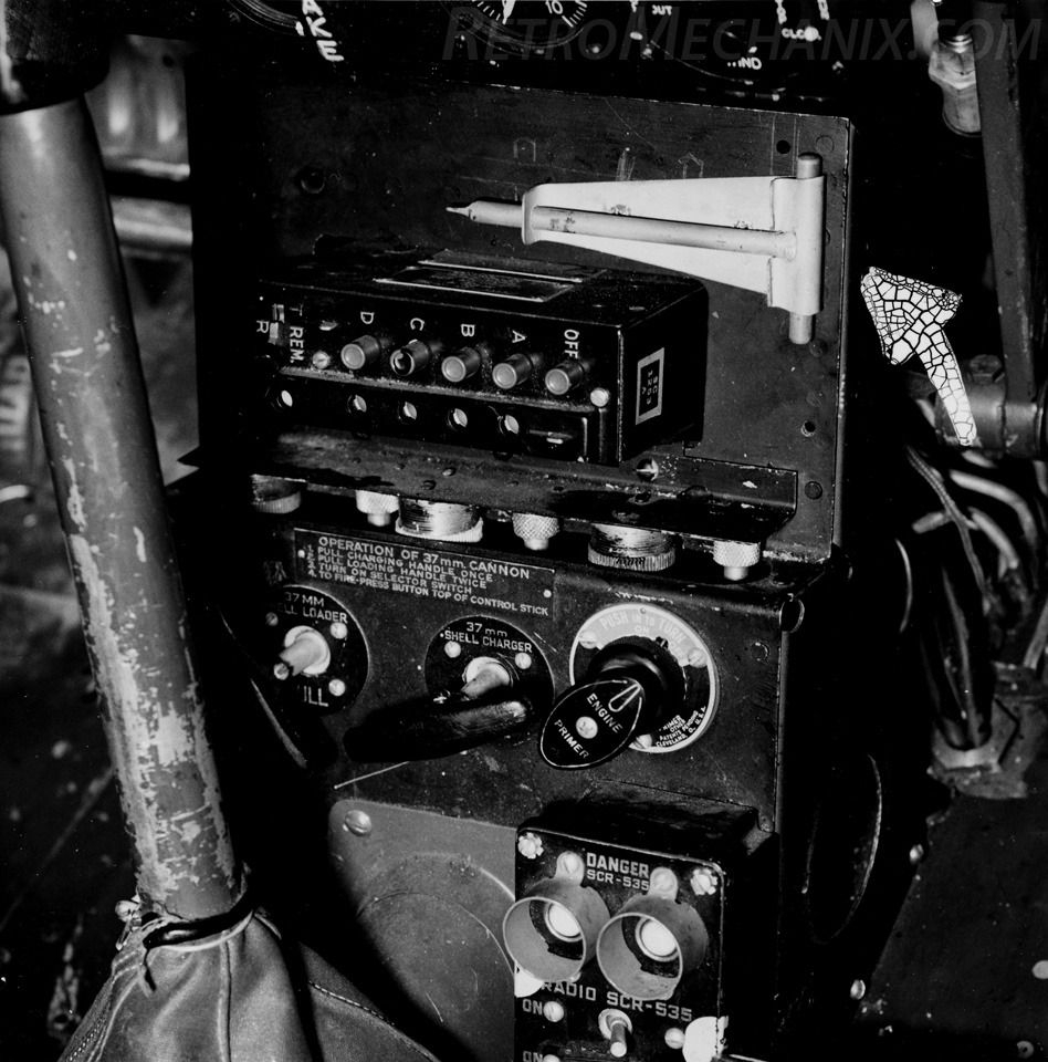

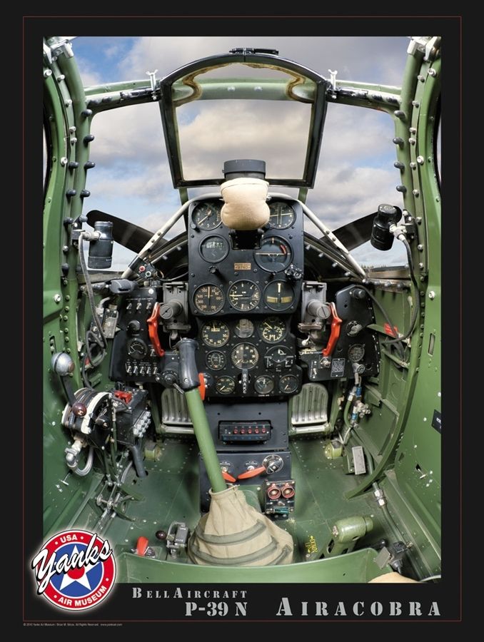

P-39's had the SCR-535 IFF as well. Here is what the control box looked like in the Airacobra:
(First photo is from this thread, and may be available for sale: viewtopic.php?f=5&t=54917&start=45 )
Note in both of these applications seen below (original WWII photo, and a photo of Yanks' restored P-39N), they also have the SCR-535/SCR-522 combination.
