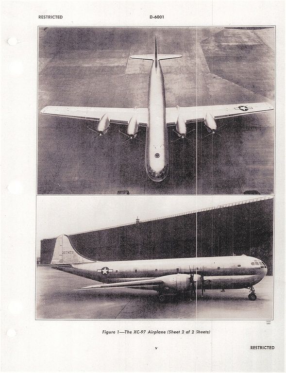

That's the XC-97 with B-29 engines and tail.
Excellent observation Larry! With the dramatically increased cross-sectional area of the fuselage (compared to the B-29), plus ramps, etc - would this aircraft fitted with R-3350's have felt noticeably under-powered compared to the R-4360 powered production C-97s?

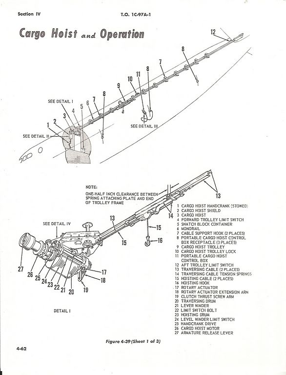

Unloading those vehicles must have been a lot easier than backing them into the plane at that angle - would they have been winched in?
Chris,
There was a winch mounted on the bulkhead behind the cockpit. I posted some photos of it in the Dodgeville WI C-97 on the thread about the C-97 that is being restored.

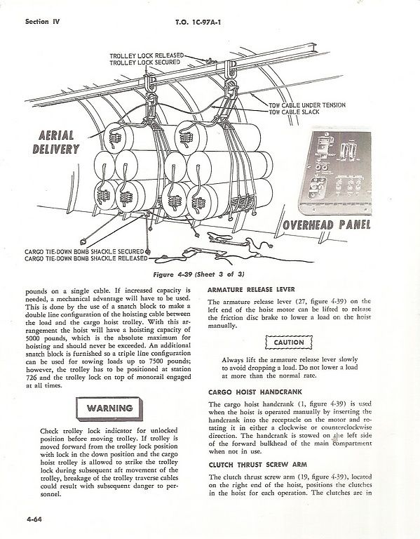

The winch your referring to is on an I-beam that extends the entire length of the cabin. The winch moves fore and aft on that I-beam.
A tail stand was put under the fuselage just forward of the clam shell doors and cargo was lifted in or out with the winch. Cargo could be moved fore and aft in the fuselage and put down or lifted up with the winch.
The production C-97's also had a forward cargo door on the right side just aft of the cockpit. The winch could service that too.

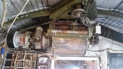

[quote="b29driver"]The winch your referring to is on an I-beam that extends the entire length of the cabin. The winch moves fore and aft on that I-beam.
In the C-97 in Dodgeville it looked as if the winch was mounted stationary and there was a block that traveled the I beam on a trolley.

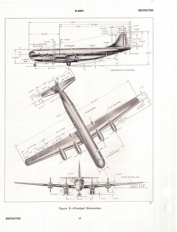

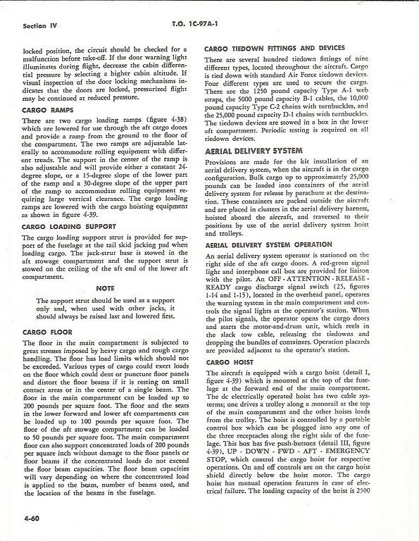

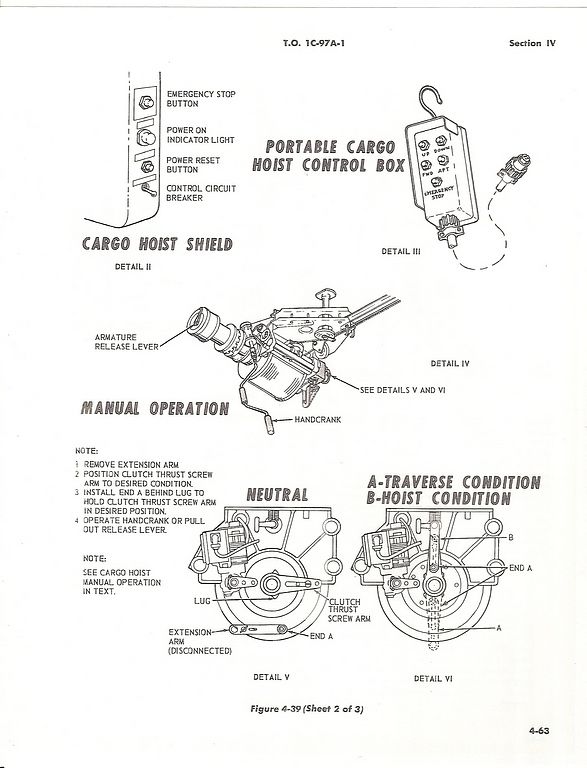

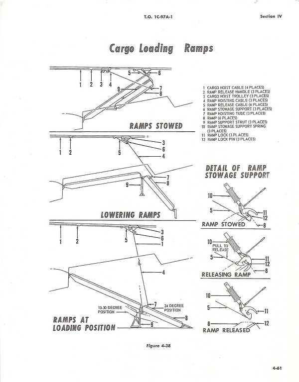

At the real risk of Too Much Information, here are some pages from a C-97 Flight Manual concerning the ramps and hoist
