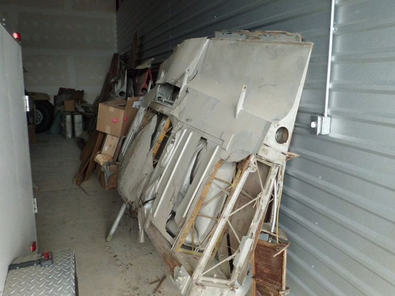

There is something inherently exciting about viewing long lost warbirds. Sometimes in a good way, sometimes in a sad way.
These two PT-19 beauties were donated to the Houston Wing of the CAF after the owner passed away. Unfortunately they have marinated for about 20 years in a boat shed.
All's they need is EVERYTHING refurbished, replaced or "buffed up." :supz:

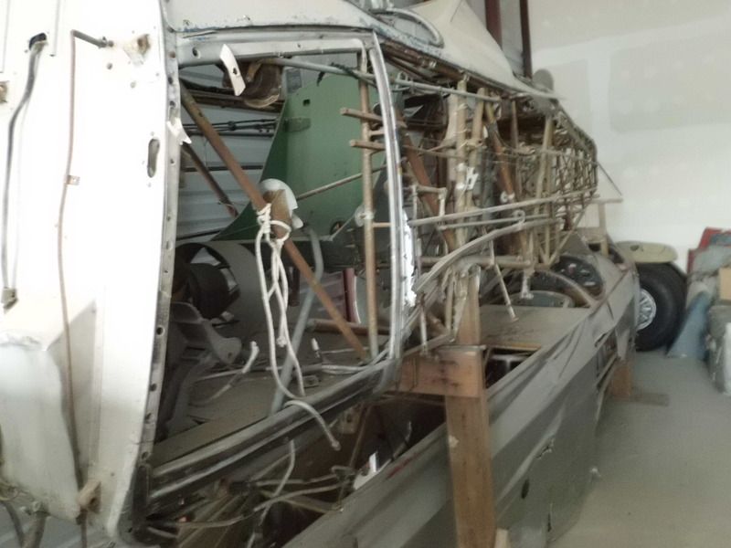

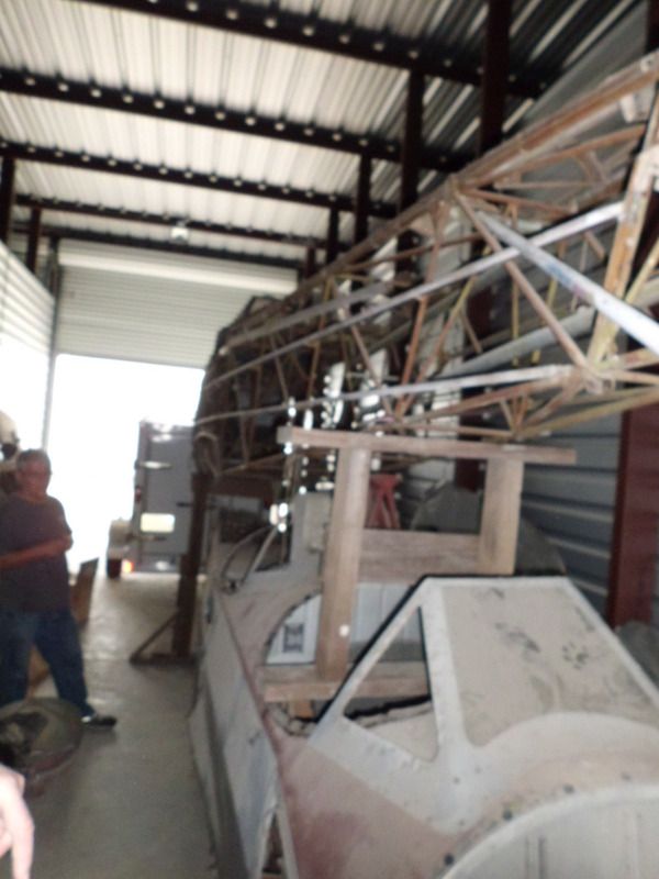

Spanner: I'd suggest talking to Mike Kelly with the Fairchild Club about inspecting the spars before you guys do anything with the airplanes restoration wise. If the spars are in need of major work or total replacement, you would need to have a frank discussion about whether the squadron wants to take on that much of a task. I think Mike figures a couple of hundred manhours to build up a new set of spars. Turning a new set of spars into a flight ready center section requires a few hundred more hours. Also casein glue doesn't like super high humidity, so watch out for that problem too. Were they mine, new wood without a doubt.
BTW, the second picture looks like there is some spar/rib material on the floor.

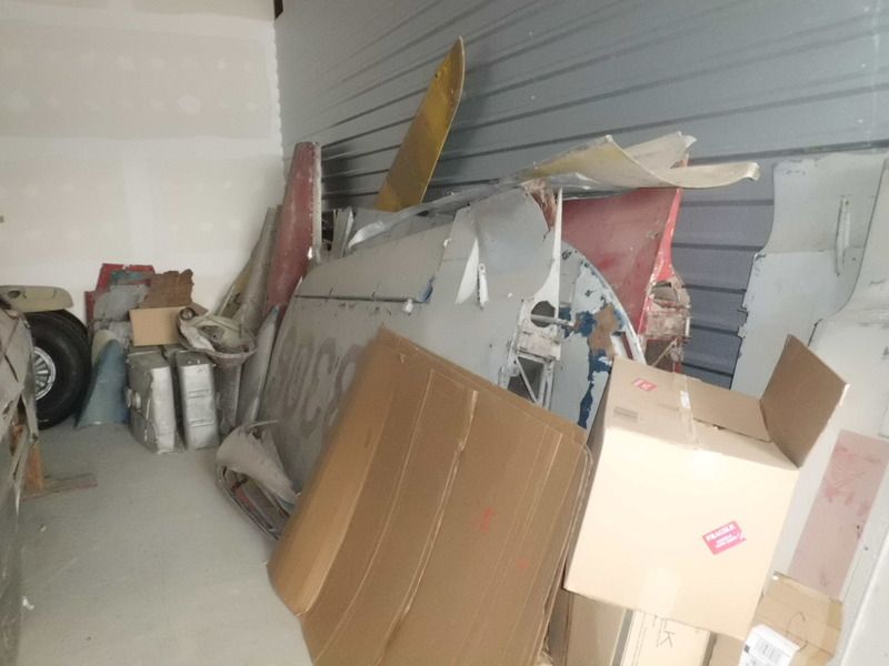

Not to worry- The wood you see on BOTH of those wings will never fly again.
They ARE being kept as patterns, and of course, for the inner metal parts.
What the Wing (as in Organization) needs are some retired wood-working folks in search of a project (or two.) :lol:

The woodwork repair and replacement takes a lot of time in these Fairchilds. (I own an F-24 and have been involved with the restoration of 2 PT-26s.)
Short version: if you have free labour of high quality through your Volunteers, then the projects are viable.
But if you have to pay for labour, then the cost of restoration of a PT-19 may be more than the market value of the airplane when completed.

Another thing to consider is that the wings and center section are skinned with 3/32 45 degree mahogany ply @ $250/per 4 x 8 sheet. The stabilizer and vertical fin use 90 degree mahogany.
Spars - Forward and aft center section spars will be about $20K for materials and labor if you farmed them out. Expect the same for the two spars in each wing panel.
If not for the volunteer labor, building up a PT basically from scratch will be much more expensive than what is already available on the market not to mention the time spent (years) to make them airworthy.
