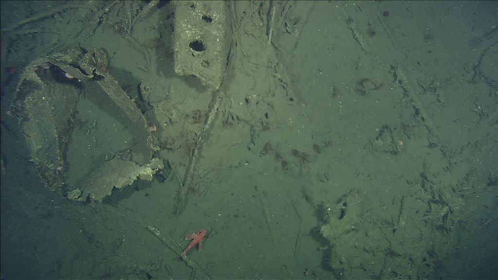

The wreckage was discovered by a team from the Monterey Bay Aquarium Research Institute (MBARI). Sonar sweeps of the area revealed no sign of the fuselage/wings and it is speculated that the salvaged components were dragged from the main body by trawler nets.

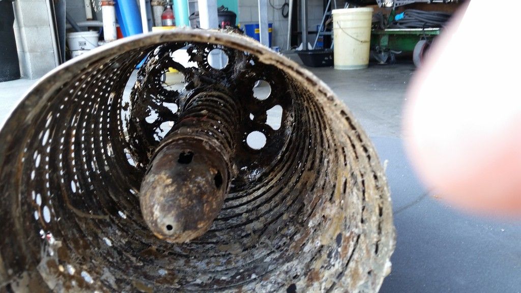

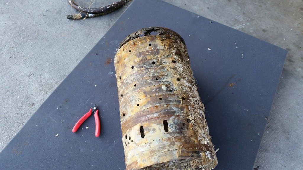

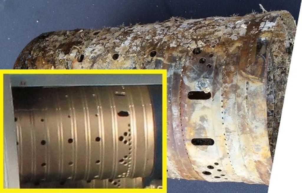

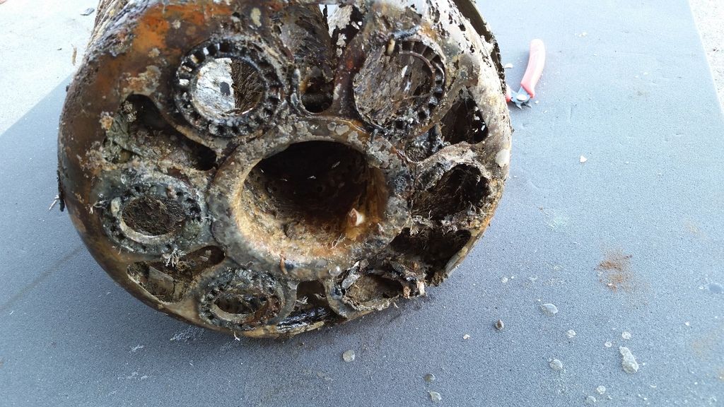

The biggest, most distinctive piece has the appearance of a jet engine .. or at least part of one.

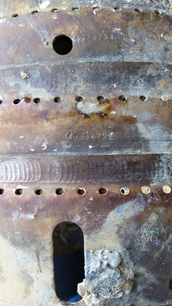

There are some part numbers stamped into the outer casing that may prove helpful ...

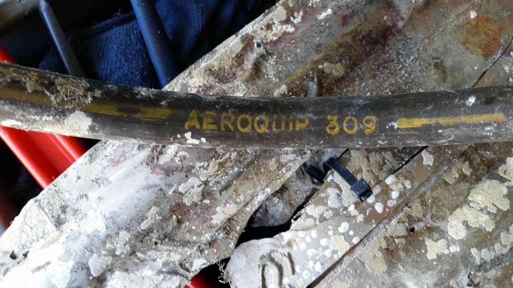

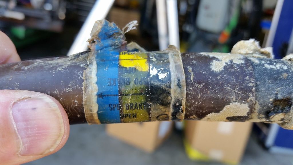

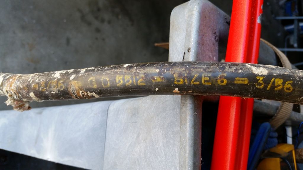

And some surviving nomenclature on associated high pressure hose as well ...

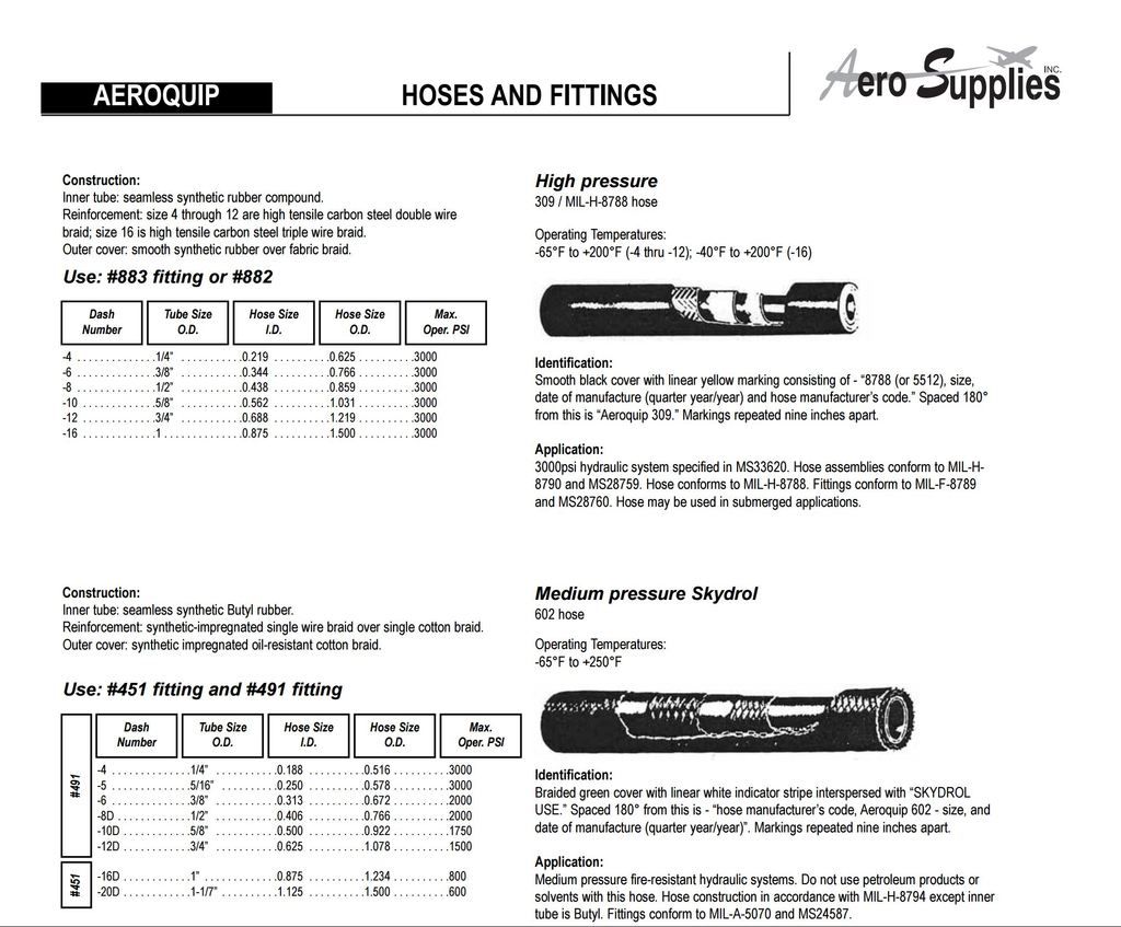

Another researcher has uncovered this page from an old parts catalogue that sheds a little extra light ...

Just looking at the shell...J47?

The cylindrical part is a jet engine combustion chamber. The six holes in the end are where the fuel nozzles would be installed. The small holes around the walls allow pressurized air in to control the flame front inside the chamber.

looks like a T-33 engine

The combustion chamber is 100% from a J-57. This should narrow the field down. F-100, F-101, F-102, U-2 , F-8, B-66 all used the J-57. Things like 707's and B-52's used turbofan variants of the J-57 and I suspect the combustion cans would be the same although if something that large were to have gone down, there would be more of it left.

Based on an image search for "J57 engine", I would agree with "One-O-Wonder" that the combustion can is from a J-57.
As for the aircraft type, it would be something that had hydraulic speed brakes (blue and yellow hose/tube markings are for hydraulic systems, and the speed brake part is printed right on it).
That might not narrow things down too much, given the number of aircraft that flew with J-57s!

3 hours and 7 minutes for One-O-Wonder to declare it to be from a Pratt & Whitney J57 (JT3) engine.

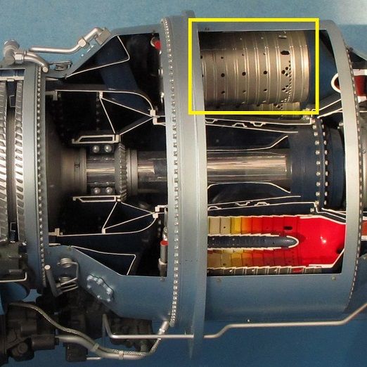

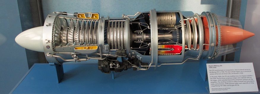

Based on this information, I also ran a quick image search on Google that turned up this cutaway scale model of the powerplant in question ...
Lo and behold, look at what we can see highlighted here ...
And now superimposed on a reoriented image of the recovered item ...
Maybe the wreckchasers will be able to help us narrow down the potential candidates. There can't have been that many operational losses over Monterey Bay. Though I suppose it could also have been from a target drone. Or there may even be an instance where an engine dropped off in flight, but the aircraft and crew landed safely. We don't know (yet). It's all part of the fun.

The hose should have a manufacture date stamped on it. Modern aircraft hose has a "Q" date, like 4Q99 would be 4th quarter of 1999. Old hose may be different. I see there's a number "5512" on the recovered hose, maybe it was manufactured December of 1955.That would be in line with the Crusader crash.
