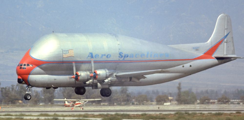

... 1965 ... at Ontario, CA (ONT) ...
... N1024V, the first Guppy conversion ...

The original Super Guppy - N1038V / N940NS would lift-off mains first. This was due to the airplane wanting to come off of the ground at lower than rotation speed. The pilots would hold forward pressure on the yoke to keep the airplane on the ground until proper speed, thus would end up wheel-barrowing down the runway. On landing it would also touch down on the nosewheel first.
My friend worked at Ellington Tower from the 1970s to the early 1990s... When NASA got the Super Guppy in 1979, he was working in the tower and the first time he saw the Guppy land, he thought it was crashing and grabbed the crash phone!
