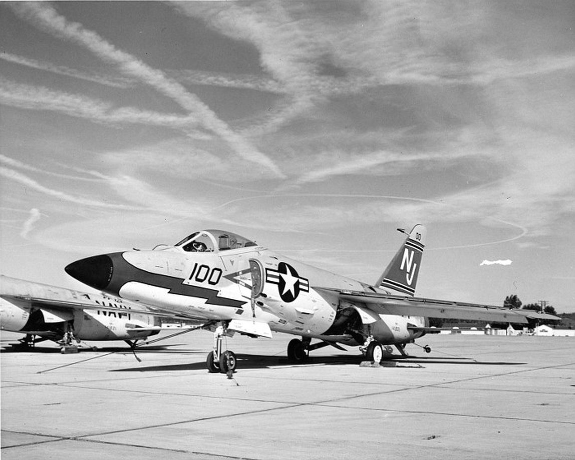

I came across this puzzling photo, of a F11F-1
The aircraft in the background,is that tracks??? or maybe my old eyes!

Looks like the put it up on blocks when they stripped the wheels. Must be a tough neighborhood.

Me thinks it's sitting on blocks and chained down at the L/G like the other one. The shadow of the wing on the starboard side of the aircraft gives the illusion there is something bigger there.

Looks like blocks to me.
We all know the USAF tried tracks on several types...the B-50, C-97 and C-82 specifically...part of SAC planning for deployment in the late 40s.

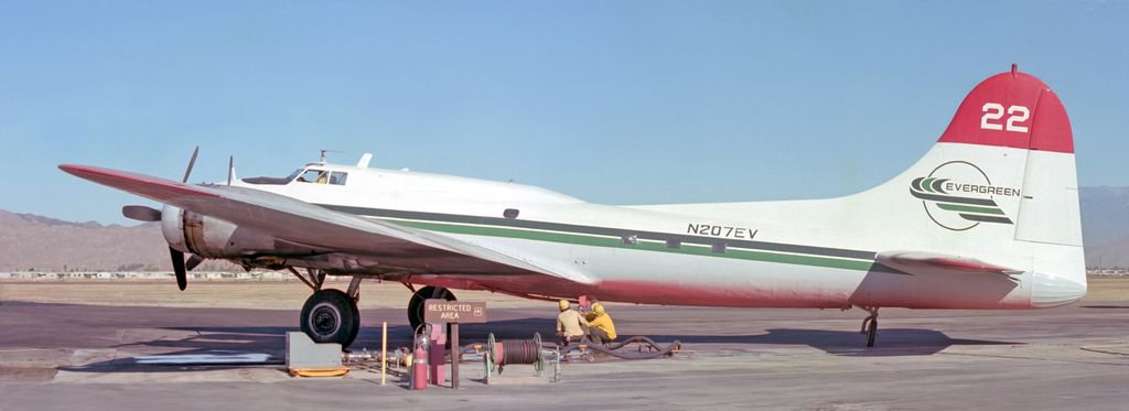

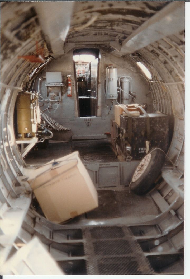

Maybe, this is what happened to the wheels and tires? During the late 1970's and through the 80's, we ran out of tailwheel tires for our B-17 air tankers. New ones could be special ordered from Goodyear, but the cost for setting up the molds and making batches of less than several hundred were prohibitive. Aero Union came up with an STC to substitue the mainmount (wheel and tire) from F11F's in place of the original tire. While better than nothing, there was no give to the sidewall in these tires and with any wieght on the tailwheel in a crosswind, the tailwheel lock would pop loose after a couple of good sideloads and the tire would turn 90 degrees and leave all of the tread in a long zipper looking wear pattern on the runway. Chuck Ott and I managed to destroy one just taxi-ing with a gusty crosswind at Alamogordo before we could get stopped. So, we carried a couple of spares and a jack in the airplane at all times.
Here's one spare in the back of Evergreen's Tanker 22 at Alamogordo in 1983.
This picture from Sledge 39 gives a good view of how narrow that tailwheel tire was. The recommended tire pressure was 150 psi, which didn't help with flexing what little sidewall there was in the tire.

John, I'll ask a few friends who worked in maintenance at that time about those subjects when I get a chance. My guess is that a significant number of the F11F main mounts were included in a government surplus auction lot that Aero Union bought. They were after P-2 inventories around that time and may have been looking into P-3's. Most of the surplus auction lots include any number of varied items and you can't pick and choose. Aero Union had some pretty clever and resourceful folks working for them and somebody put 2 and 2 together.
I thought that there was room on the B-17 tailwheel fork for two of those tires, which might have given a better footprint, but one worked, sort of....As imperfect a solution as it was, something had to be done. The last real B-17 tailwheel tire that I used had cracks in the sidewall wide enough that you could lay the side of your finger into them while parked with the airplane loaded. I never had a real B-17 tailwheel tire blow out, but it was known to happen as they got in that condition.
