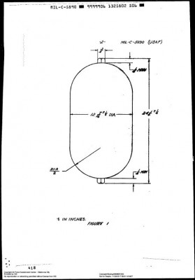

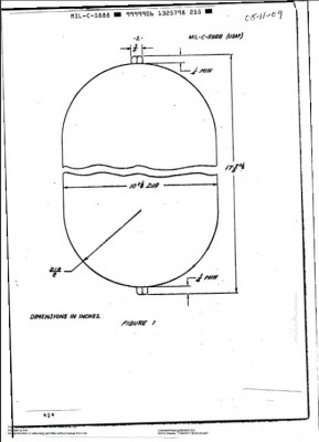

You mean these?????
File comment: MIL-C-5888 Type F-1
File comment: MIL-C-5890 Type G-1

Thanks Brandon. That helps a bunch. I see that MIL-C-5888 has been superseded by MIL-DTL-5886, so I was able to find some of the other data that I needed. Quick question....does your copy of 5888 show that it superseded a previous spec? The info that I could find shows that 5888 came about in 1951 and it's linage might show the Air Corp spec from WW2. I know a bunch of my electrical parts call outs reference Air Corp Specs in a 94-xxxxx series, which I haven't been able to find a source for, along with some early AN30xx specs.

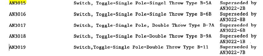

Any chance of having AN3015 thru AN3019 in your library?

File comment: Excerpt From MIL-BUL-543A
From MIL-BUL-543A...
All superseded by AN3022
Don't have access to the actual AN3015-AN3019 specs though.

Thanks Brandon, I've also managed to find where I can purchase a copy of the Mil-Bul-543 too. Hard copy is $95, while electronic copy is $10.
