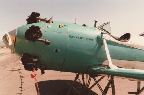

I've never been in the Stearman, but I did learn to fly in the Ryan way back in the '70s. :D
