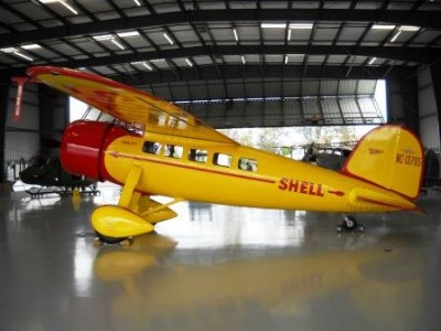

The late John Desmond's Lockheed Vega, which recently flew after restoration to airworthiness, has been restored in Shell Oil colors as one of the Shell Vegas that Jimmy Doolittle flew. Is it in fact one of those airplanes, or has it simply been painted in his Shell colors? I read somewhere that there was some controversy as to whether or not the dataplate "was legitimate," whatever that means.

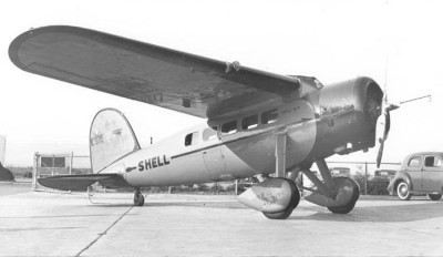

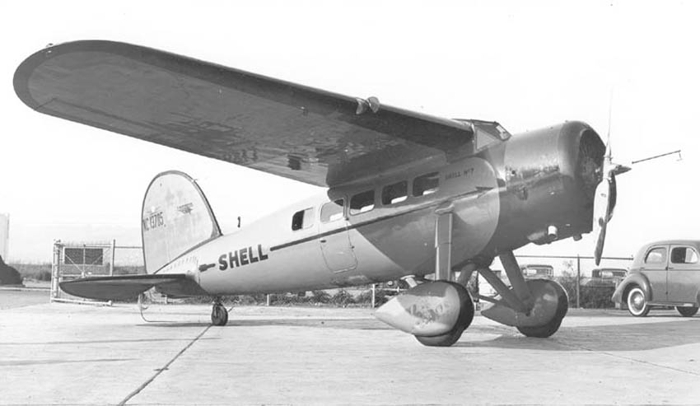

Stephan,
The best way for people to view this question is quite simply a legal one. Your question as I understand it was that James Doolittle flew, among other aircraft, Lockheed Vega c/n 203 that was registered as NC13705. This aircraft has been restored and is currently registered with the FAA as N13705. The Lockheed c/n accepted by the FAA is 203. Remember the Vega is a wooden aircraft, and so many components would have to be periodically renewed. The last original and unprepared wooden Lockheed fuselage and wings flown may have been over 40 years ago. It’s important to remember how difficult it is to chase down an aircraft almost lost to time, meet with people, and begin a restoration. This aircraft is emblematic of the restorers art, and represents tremendous effort on the part of many people to save aviation history.

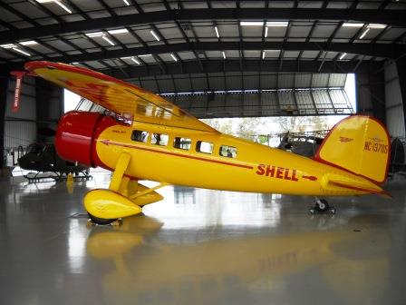

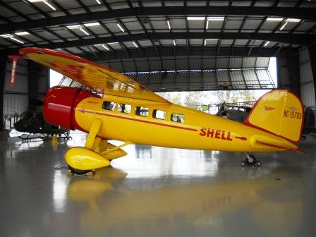

The Vega in question is currently at the Nut Tree Airport, but has not flown
The Vega was restored using 10-15% (according to owners) original components and materials wherever possible, (mostly metal fittings and hardware) upon the remains of the existing airframe. The remainder was returned to accurate early condition made with the same materials as the original. The restoration was started in 2011 and took about 5 years to complete. The aircraft was restored to air-worthy flying condition, although currently there is no pilot to fly the aircraft. Last I checked, the aircraft was undergoing inspection for possible sale.
There is a major issue with the glue (not FAA approved) that was used in the restoration.
There is no original Data plate, a replica data plate is in the aircraft.
I consider the aircraft “Restored/rebuilt” - a flying aircraft composed of some original material but mostly constructed from new parts built to original specifications – it utilizes identities gained from source material so as to have a "provenance" but is largely "new build". Almost all of the wood fuselage and wing is new construction using original type materials and methods.
The real question is, Is it "SAFE" to fly?
It is a tail dragger with poor forward visibility.
