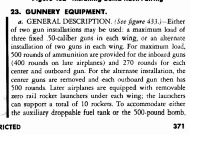

F-51D Mustang Handbook wrote:
Either of two gun installations is possible: (1) three fixed .50 caliber guns may be installed in each wing, with 500 rounds (400 in late airplanes) of ammunition for each inboard gun and 270 rounds for each center and outboard gun; (2) the center gun may be removed, allowing the inboard guns to carry 500 rounds (400 in late airplanes) each and the outboard guns to carry 500 rounds each.

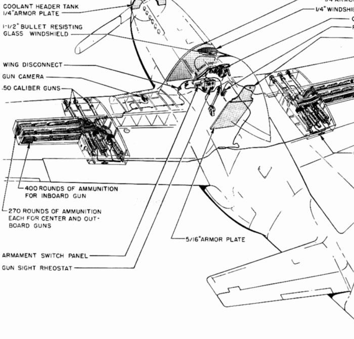

PostPosted: Thu Oct 04, 2018 5:13 pm
Posts: 3236
From the Maintenance and Erection Manual for the P-51D/K
Saludos,
