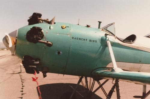

I voted the Ryan, but it's out of biased nostalgia.
I've never been in the Stearman, but I did learn to fly in the Ryan way back in the '70s. :D
remember the Oogahonk!
