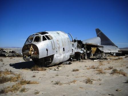

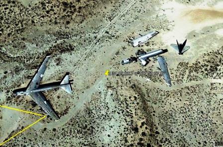

The remains of B-52E, serial number 57-0119, At Edwards AFB abandoned in the desert which was used by General Electric during the 1960s to test their new TF-39 engine, designed for the Lockheed C-5 Galaxy. It was blown up to comply with the Start treaty I was told, but most likely they just wanted to have some fun with explosives.
The other B-52 in the Google image is RB-52B, which was transferred to the Air Force Flight Test Center at Edwards in 1965 for use in barrier testing. The bomber, serial number 53-0379A, was struck off charge in 1970.
