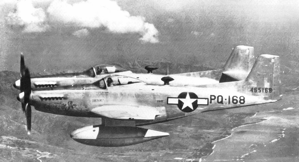

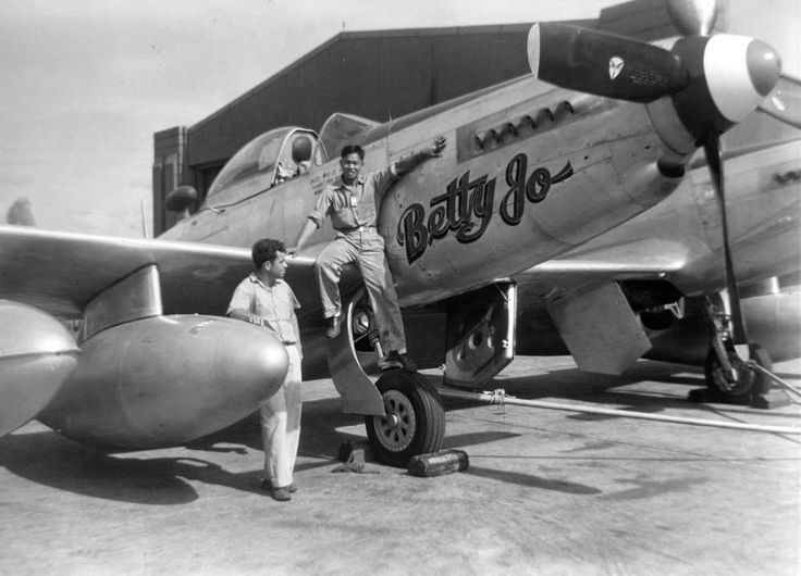

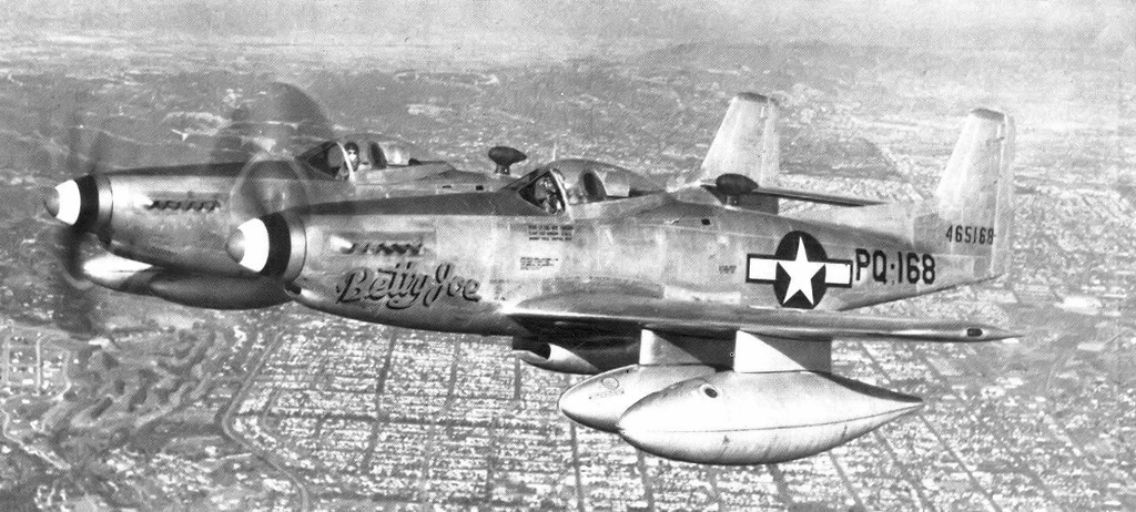

I don't know if any of these photos would help. Wikimedia says 310 gallon external tanks.
1280px-F-82B_Betty_Jo_44-65169_Flying_over_Los_Angeles_1947 (1024x462).jpg [ 356.64 KiB | Viewed 2779 times ]
1280px-F-82B_Betty_Jo_44-65169_during_record_flight_27_February_1947 (1024x555).jpg
1280px-F-82B_Betty_Jo_44-65169_during_record_flight_27_February_1947 (1024x555).jpg [ 404.76 KiB | Viewed 2779 times ]

The P-82 was capable of carrying up to four 310-gallon drop tanks, as "Betty Jo" did on the Hawaii to New York flight. Some other photos of "Betty Jo" also show it fitted with two 310-gallon tanks and two 165-gallon tanks. When I toured C&P Aviation a few years ago, they had a pair of reproduced 310-gallon tanks (massive!) which I believe were to be provided for display with "Betty Jo" at the USAF Museum (I recall that the tanks that the USAF Museum did have with the aircraft were the smaller 165-gallon type). There are a number of publicity photos that can be found online showing four of the 310-gal type tanks all lined up on their noses next to P-82 44-65160 (PQ-160), designed to illustrate just how large they were (more than 13 feet long). I've also seen some photos of some regular service F-82's carrying 150+ gallon "Misawa" style drop tanks.
During WWII, P-51D's carried a pair of; 75-gallon metal tanks, 110-gallon metal tanks, or 108-gallon and 110-gallon paper tanks. To a limited extent, there were some missions flown from Iwo Jima where P-51D's were fitted with a pair of 165-gallon metal drop tanks, for the loitering missions (capable of spending up to three-four hours in the air over Japan, as I recall) - by that point, they were using P-51D-25-NA's with beefed-up wings that could support up to 1000-lbs payload on each side.

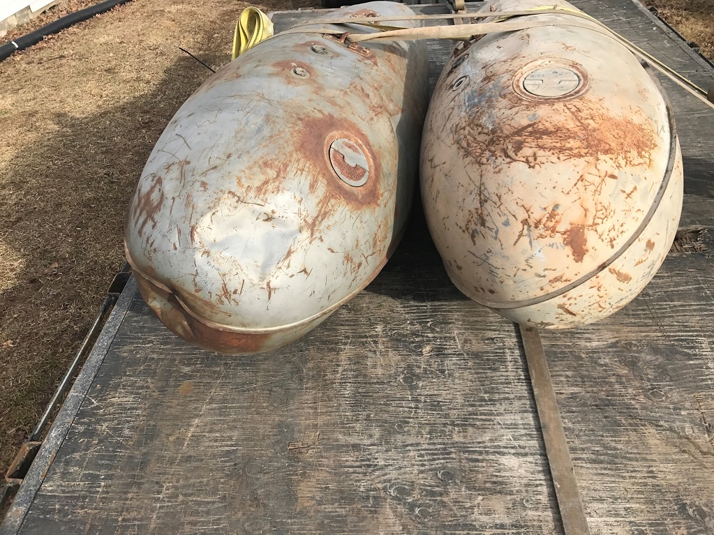

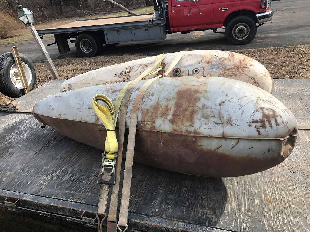

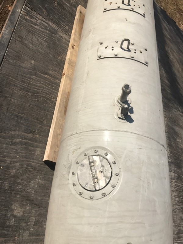

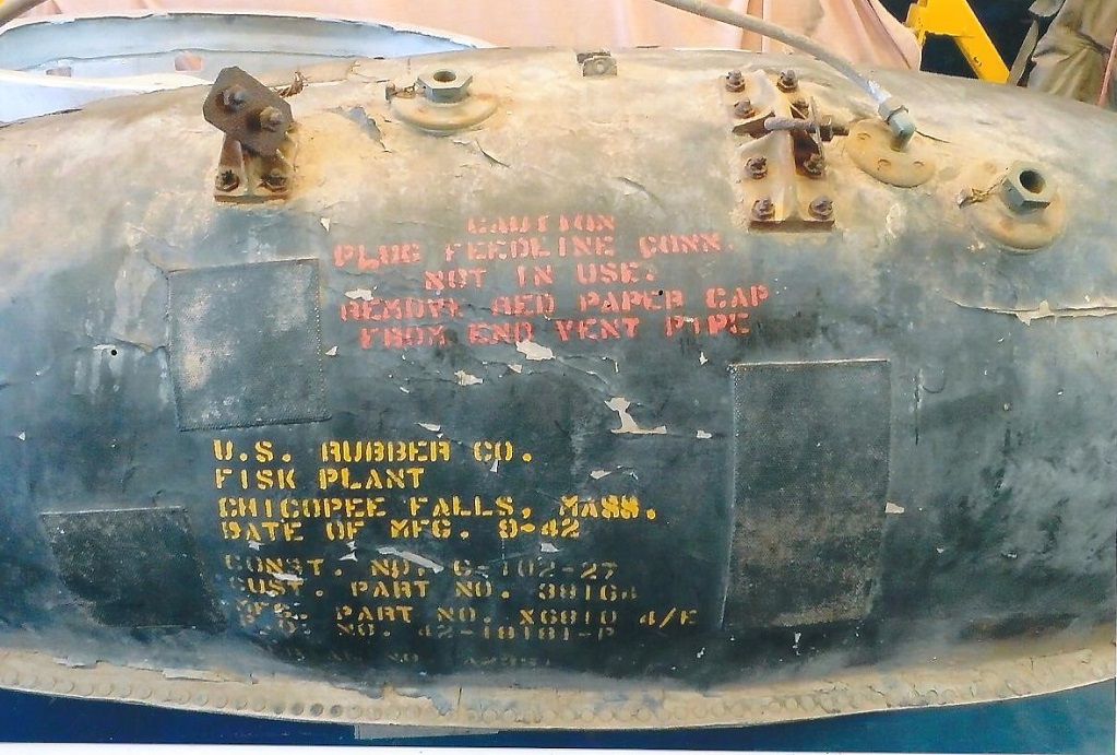

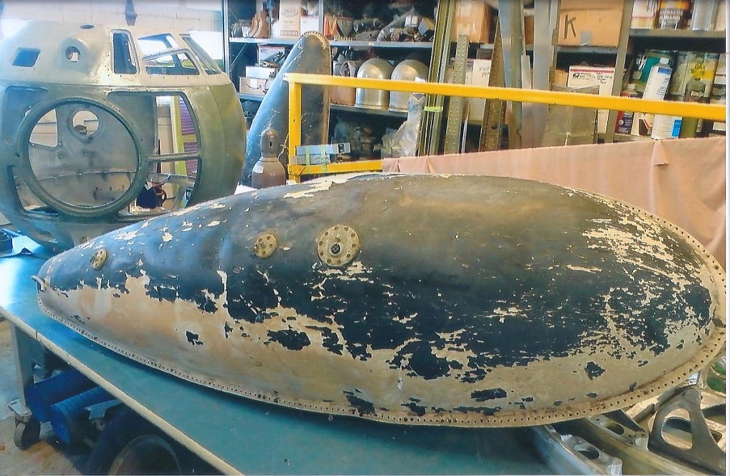

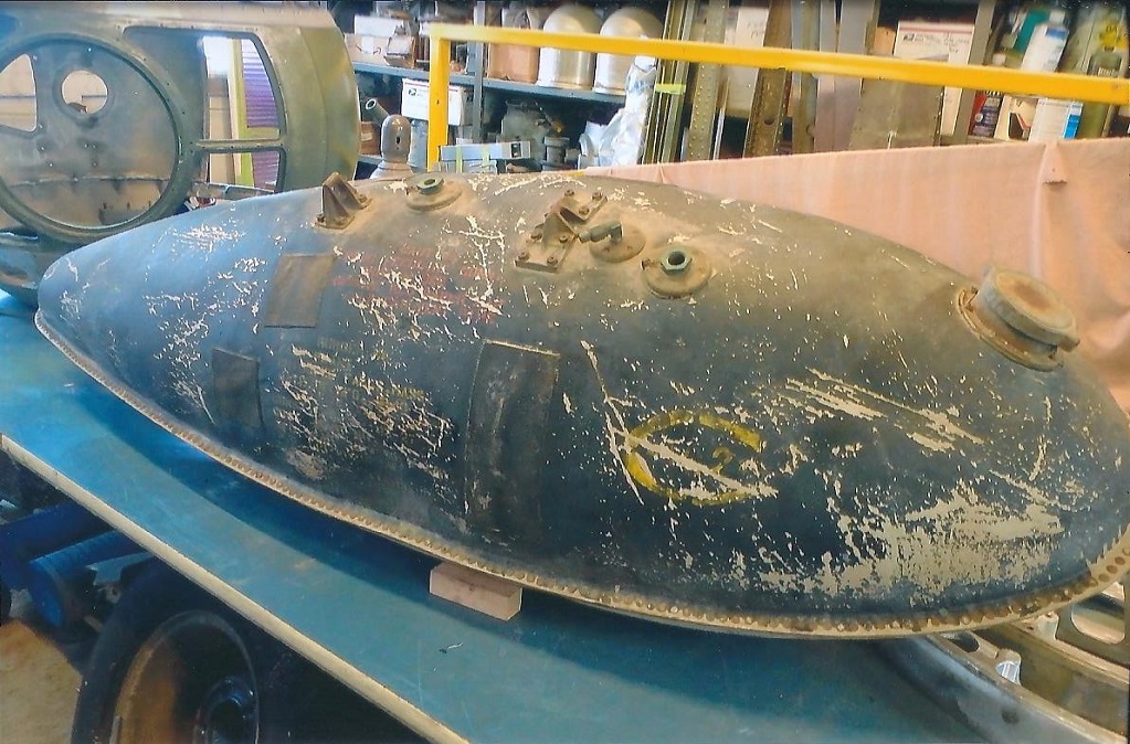

Noodling around on the interwebs, I found these photos of various drop tanks. The long skinny white ones look P/F-82ish. I found a google image picture of an F-82 in flight with very similar tanks, but I cant seem to find it now.
PostPosted: Thu Feb 07, 2019 5:09 pm
Joined: Tue Feb 05, 2019 12:12 pm
Posts: 6
Location: Prospect, CT
