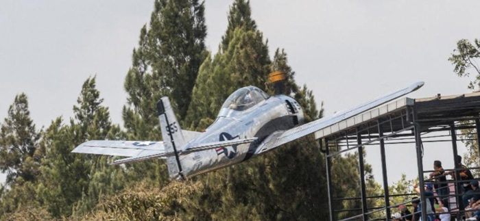

The aircraft crashed while performing low level aerobatics at a car race. The pilot and mechanic passenger did not survive the accident.

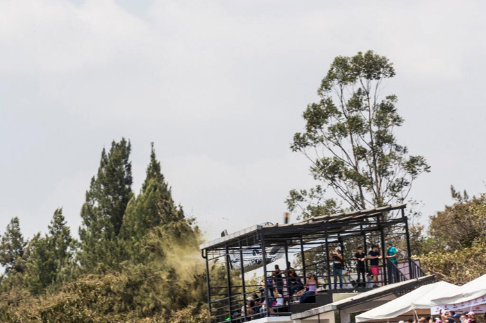

To me it doesn't look like aerobatics except in the FAA's definition of anything more than 60 degree banks. It looks like he was buzzing the heck out of them and his aggressive flying exceeded his flying ability. The last shot looks like he is really winding it up to make a high speed buzz job and while he is dishing out on the bottom, he misjudged the width of the gap in the trees. He hit the tree on the right very hard. I think the tree on the right is what caused the aircraft to go out of control.
He was trying to make an impression on the people in the stands and he did. A better buzz job would've been to go over the direction of the track instead of towards the tree line.

Looks to me, like he was coming out of a loop, and ran out of airspace. The short video most people have seen, shows the airplane at a high rate of speed, coming out of the dive...

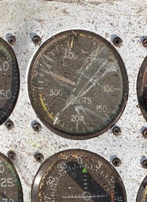

I won't believe it was a loop until I see an entire video. Usually when someone screws up they recognize it coming out of the top of the loop and chop the power, in some cases drop the flaps and get the nose up to a maximum L/D nose high angle. In this case the airspeed indicator indicates he hit the ground going 340 knots (391 mph.) To me, that suggests a full throttle, screaming dive at the ground . Then we he went to pull up the momentum continued the downward path. Had it happen to myself, but wasn't flying nearly as aggressively. I think you guys are giving too much credit to say he knew how to do low level aerobatics.
Honestly, the people in the stands were probably terrified.
