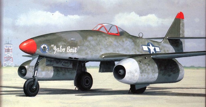

Just thinking out loud, but could the red around the forward windscreen be some sort of surface protection for the material? Does anyone know what these windscreen structures were made of? I cannot think of a reason to paint these red, but I can see that this would be one of the first places where the top paint layer would erode.

File comment: Me 262 with red markings from cover of War Prizes by Phil Butler.
The above image is from the front dust cover of War Prizes by Phil Butler and shows an Me 262 after American markings have been applied in the US and with red nose, canopy and vertical stabilizer tip painted bright red. My thought is that this is to alert US ground crewmen that it is a jet aircraft with danger areas in the front (the engine intakes) and the rear (the jet exhausts). I'm not sure about the canopy being red unless it is to again indicate a jet aircraft. I have seen photos of captured Arado Ar 234 jets in the US with red painted rings around the engine inlets. This scheme seems to be applied to those captured jets that were most test flown in the US. Just a theory until I find more info.
