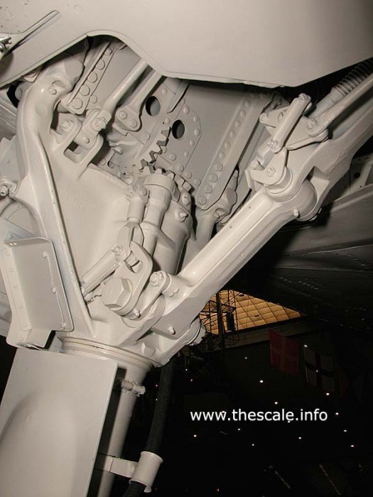

Given that the outer wheel hub is showing as facing forward in both pictures, the catch netting is deployed in one picture, plus if I remember correctly, the undercarriage rotated prior or during retraction/deploying, is it possible that the retraction mechanism has failed/not locked, resulting in the wheel hub facing forward and what we are seeing, is the aircraft in a 'controlled' crash?
Don't know, not even sure if the capture netting would be deployed for all landings though would have thought that this was unlikely, in case the pilot had to abort their landing so I'm just guessing...

Could be something as simple as the bolt falling out of the scissor link. Both instances pictured look like the gear leg is still well locked into place.

Hopefully I've attached a picture of the mechanism that caused the gear leg to rotate as it extended or retracted. This image came from this thread:
https://forum.largescaleplanes.com/inde ... t/page/11/
The mechanism itself seems pretty fool-proof, but then the above images seem to indicate it wasn't completely impervious to battle damage, or gremlins.....
