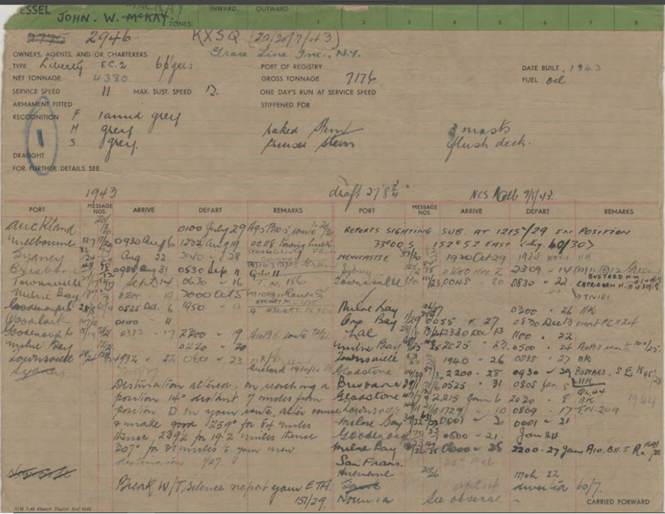

Thank Bus. Do you happen to have details of which ships left from which ports? I am interested in the batch of P-40N-1's that arrived in Auckland on or around the 27th of July 1943, aboard the "John McKay" according to RNZAF records, but I suspect that may be the Liberty Ship USS John W. Mackay.
PostPosted: Tue Apr 09, 2019 4:56 am
Joined: Mon Nov 29, 2004 8:36 am
Posts: 133
Location: Not Canberra, Australia
Dave
Funny you should ask about that ship and those aircraft
I have them to San Francisco by rail between the 9th and 11th May 1943. My shipping data states John W MacKay (Aus Records also had the name wrong as they called it John W McKay but was pencil ammended)
Details Liberty EC2 - Painted Grey Funnel, Hull and Superstructure. Owners Grace Line Inc NY (Signal KXSQ). Australian records show her into Melbourne Ex Auckland (depart 29 Jul 1943, arrive 06 Aug 1943).
Buz

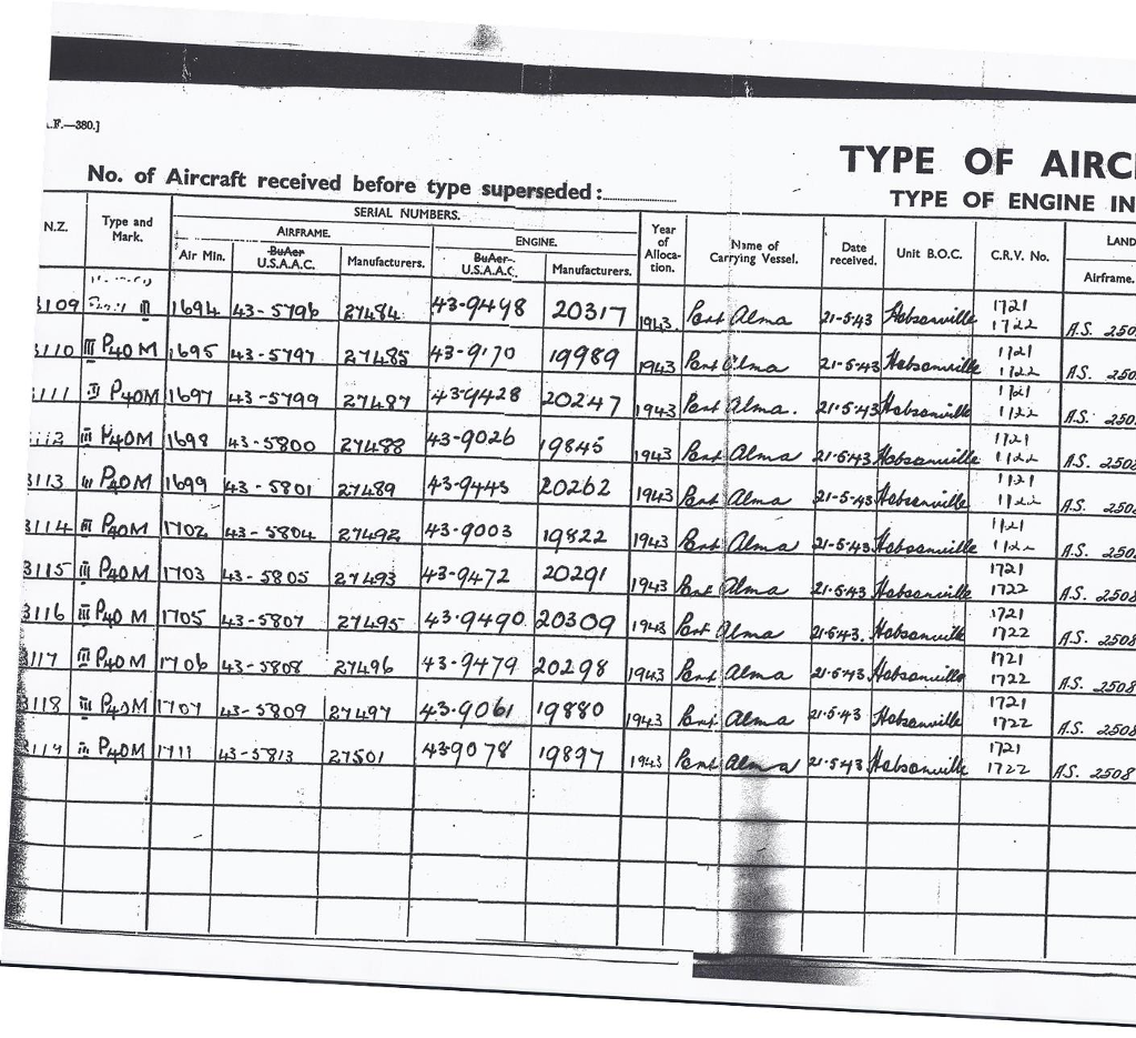

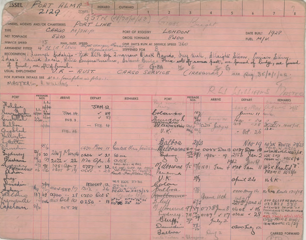

Would you happen have similar information on the ship Port Alma?[1][2] It delivered at least 11 P-40Ms to New Zealand on 21 May 1943.
If not, could you explain how you found the information in the above post?
File comment: From the Royal New Zealand Air Force Aircraft Register, part 1
File comment: From the Royal New Zealand Air Force Aircraft Register, part 2

Hi Noah307
All of your aircraft were actually slated to go to Australia, but for some reason were diverted to New Zealand (yet to find out why), two primary source docs confirm that the aircraft were for Australia. All were sent to the United Nations Depot Buffalo between 18th Jan to 21st Jan 1943 before being dispatched by land to their POE - strong possibility they departed New York as I haven't found any further information about being transshipped anywhere else.
I base the thought that it was from New York as Port Alma seems to have gone back to Balboa with what looks like notes going to Glasgow in in Aug 1942 however the card is very difficult to read, and there seems to be no further trace until Nov 1943 in Australian Waters, so there is no positive proof of where she picked these aircraft up from (I haven't looked for the ship log but its not my area of interest).
Buz
