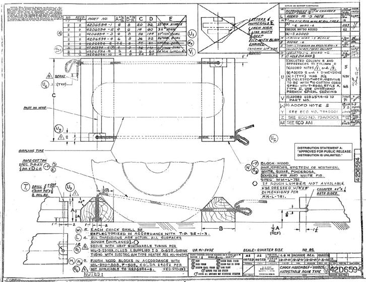

Anyone have or know of a source for dimensional drawings for aircraft wheel chocks? I assume there would be different sizes of chocks for different sized aircraft. I'm also assuming the Air Force would specify a particular dimension for their chocks.

This gives you most of the dimensions: MIL-PRF-32058
The profile drawing is: 42D6594 Chock Assembly-Wheel, Adjustable Rope Type
Angle on the faces should be 45 degrees. Sample dims here: https://www.google.com/search?biw=1533& ... AP69Q3AcAM:

42D6594 Wheel Chock Drawing
File comment: 42D6594 Wheel Chock Drawing
