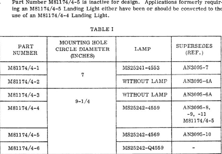

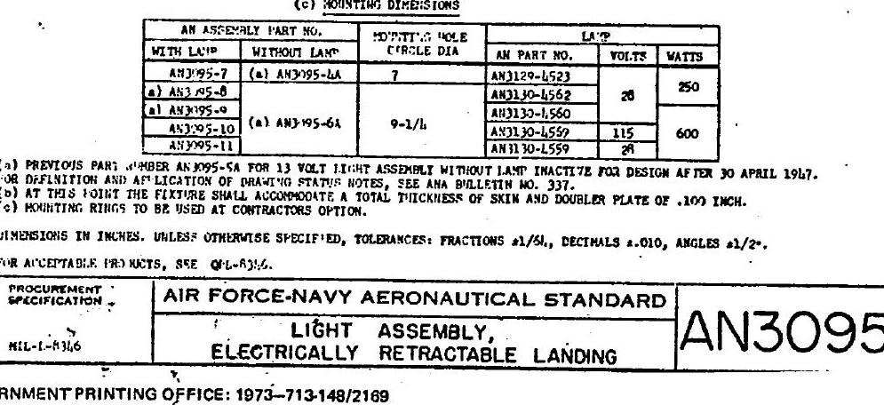

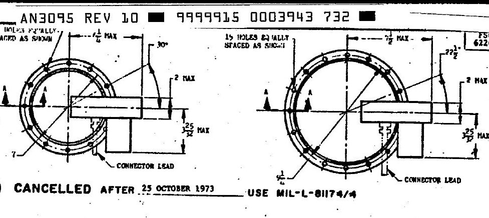

Posts: 11336
Use MIL-L-81174/4A
Does any of this help?
