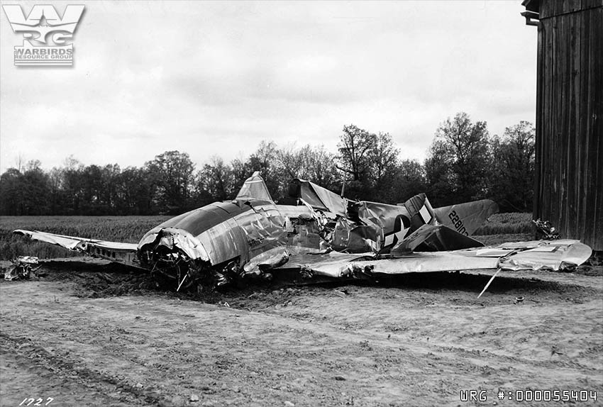

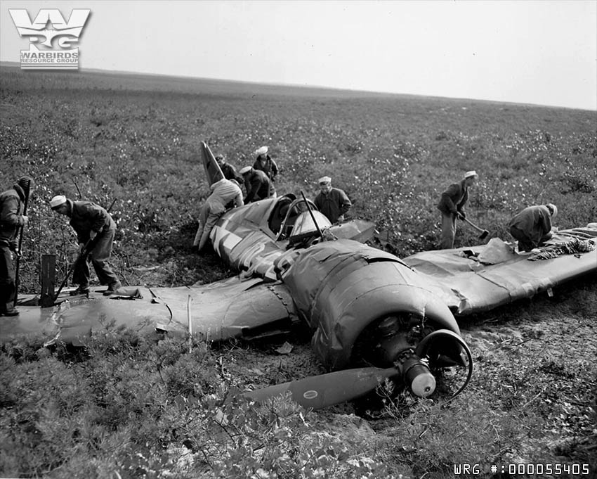

No accident reports that I can dig up on either one, but they sure look like they both just fell out of the sky straight down.
Stateside Thunderbolt complete write off.
Stateside Corsair completely destroyed.

The P-47 looks like 42-28103. If so, the Aviation Safety Network site shows w/o accident for this ship on 3 May 44 4 miles north of Evansville, IN airport. It also lists a w/o for P-47 42-28106 same date, same location. Perhaps a midair or ground collision.

Just checked aviationarchaeology.com. It shows both P-47s in my previous comment were involved in a midair collision 3 May 44 north of Evansville, IN airport. Both pilots bailed out.

I've seen photos of other crashes where the remains look similar to these, usually as the result of a (flat) spin.

The rate of descent when the Corsair hit must have been tremendous and I too would suspect a stall/spin. Look at how the one prop blade is curled nearly around the hub, the dihedral in the Wings nearly non-existent, and the vertical crushing of the fuselage. I certainly hope the pilot successfully bailed out as I fear the G forces would have likely killed him.

Vi Baughers website...
42-28103 (MSN 1765)
Republic Aviation Corporation, Evansville MAP, IN; Mid air collision 3May44 with P-47D 42-28106 and crashed 4 miles N of Evansville; Pilot bailed out

It seems both aircraft probably spun in. The Corsair might have been on the bottom of a loop but the fact that it's all in one piece sort of, and how the ground is fairly unscathed also suggests a spin. Neither would've been survivable. From the descriptions of Jeff Ethell's P-38 crash, this is how I imagine that P-38 looks. I'm told it's a terrible candidate for a rebuild.
