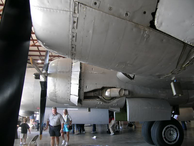

I was uploading some of my pictures from the 2005 Airsho in Midland and have a question. Can anyone tell me what the rectangle object underneath the #1 nacelle is in the photo below? I think it may be a catch can for fluids since it has a cap on it, but I’m not sure.
Yes, the cans are for collecting oil. In the past, used water bottles were stuffed in the cowlings to collect the oil dripping from the engine intake drains. I simply fabricated some tubing and installed a shut-off valve inside the nacelles to facilitate a more "user friendly" and cleaner set up. When we shut down, we simply screw the cans onto the fitting that protrudes from the nacelle and turn the valve on. It depends on each particular engine, but we'll generally fill one of the cans up in a few days. It's not a perfect solution, but better than letting it drip all of that oil on the ground, and slightly better looking than plastic water bottles poking out of the cowlings.

Thanks for the answers Rohr and Gary.
