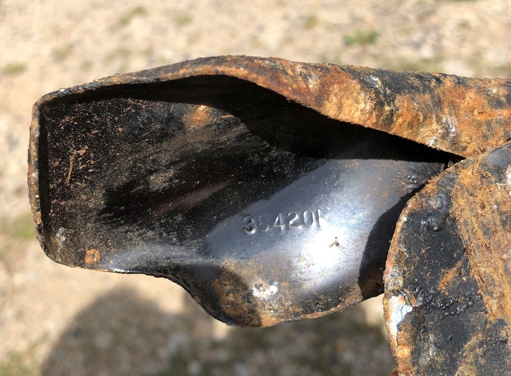

Recently we've been researching the death of U.S. Navy Pacific ace Harry Brinkley Bass in the south of France in 1944. The cause of his crash will probably now remain a mystery unless we can find a reliable witness account or other information. However, we did find the crash site and some very few remains of the aircraft. Does anyone out there have a parts catalogue for the F6F-5 who would be kind enough to look up a part number for us ? We'd appreciate it very much.

This looks like a small elongated inspection or maintenance cover, with upturned edges and fitted with quarter-turn quick release screws. It's painted black, as is the panel that it was fitted to. The part # is very clearly 354201
Thanks again for your help.

I looked the number up in the Parts Catalog & also in the F6F Microfilm Blueprint Index I made & couldn't find that number. I wonder if it is a part of the R-2800?
Hope that helps,
Mac

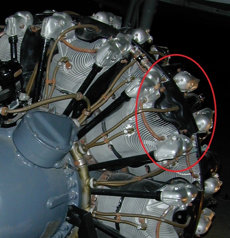

Hi Mac, thanks for responding, you're absolutely right. It's a P&W part number. Someone else also picked up on it. In fact, it's one of the spark plug covers.
Why is this important to the story ? Because we now have engine parts, cockpit instruments, spent or exploded 50 cal shells and pilot's effects all within a tiny radius which appears to indicate a near vertical dive into the ground with no forward vector. This corroborates witness reports from the time and may help explain what happened. Thanks again.
