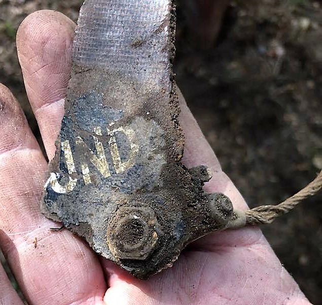

Can anyone help to confirm that this is the headset jack socket from the jackbox on the right hand side of the cockpit ? We can't find a picture of it anywhere.
The lettering appears to be the last three letters of the word 'SOUND' or 'GROUND' or something else.
Thanks for your help.

Looks like a receptacle to electrically ground the aircraft on the ramp.
Re: Hellcat F6F-5 parts to identify
Fri Sep 20, 2019 2:37 am
The piece of wire gives the answer. Static ground point. The only things that uses 2 or 3 wires wrapped around a core of wire, are static grounds. Notable other places to find them are on control surfaces and hinged doors and panels.

flypa38 wrote:Looks like a receptacle to electrically ground the aircraft on the ramp.
That's great, and it makes much more sense. Thanks. Any idea where we could find a picture ?

Cvairwerks wrote:The piece of wire gives the answer. Static ground point. The only things that uses 2 or 3 wires wrapped around a core of wire, are static grounds. Notable other places to find them are on control surfaces and hinged doors and panels.
Sounds good but I'll get a photo of the back side so you can see the electrical connections. Can anyone send a picutre of the static grounding of a hellcat ?

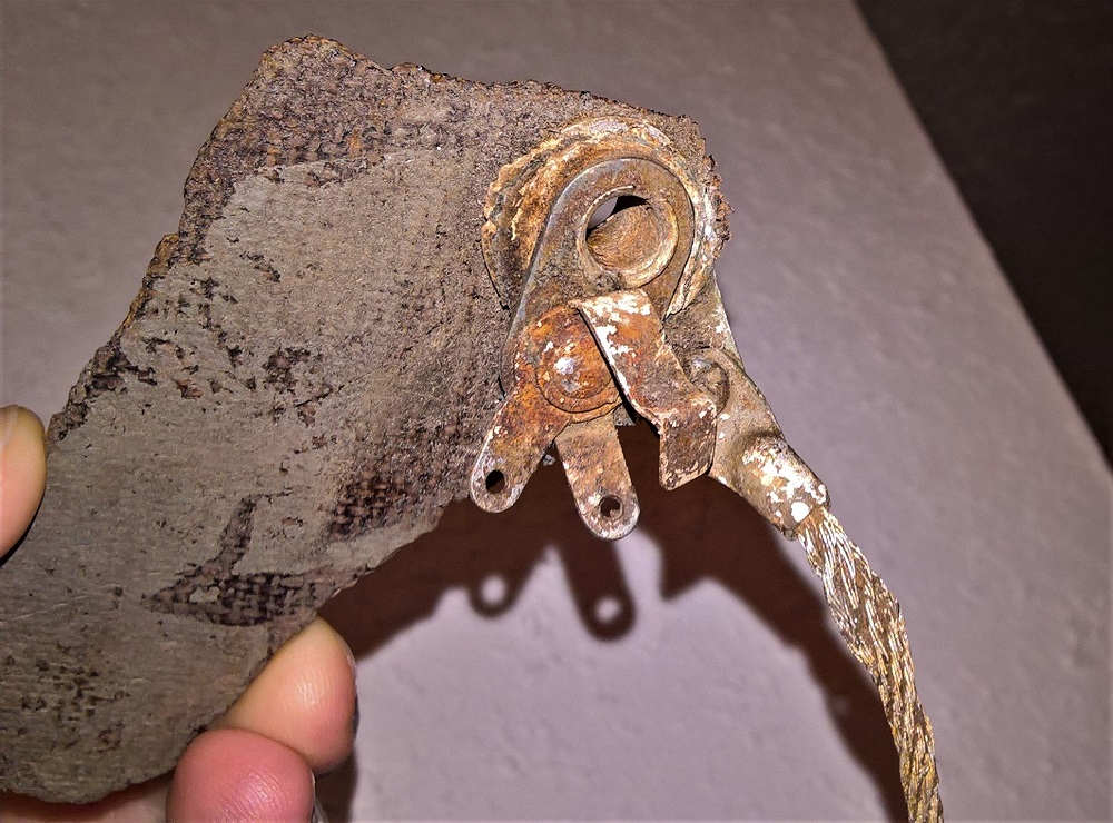

Here is a picture of the back of the connector. Does this confirm the static gounding point and give a clue as to it's location on the aircraft ?

Wash off all the dirt and you can verify that all three of the small eyelet terminals have continuity with the flex tab and the body. The only thing that uses this type configuration is a static ground point. The labeling on the other side would be consistent with a ground point too.
The pilot's headset would have plugged into a J-22A jack box on the right side of the cockpit. The J-22A would give the pilot a mix of all 5 receivers installed in the aircraft.

Cvairwerks wrote:Wash off all the dirt and you can verify that all three of the small eyelet terminals have continuity with the flex tab and the body. The only thing that uses this type configuration is a static ground point. The labeling on the other side would be consistent with a ground point too.
Thanks, that all makes perfect sense but where was this grounding point on the aircraft ?

Definitely a static grounding receptacle. I have the same units all over the F7U.

Ian03 wrote:Thanks, that all makes perfect sense but where was this grounding point on the aircraft ?
Ian: No idea on the Hellcat. One thing that might help, is that it appears to be mounted on a piece of fiberglass or some sort of composite.

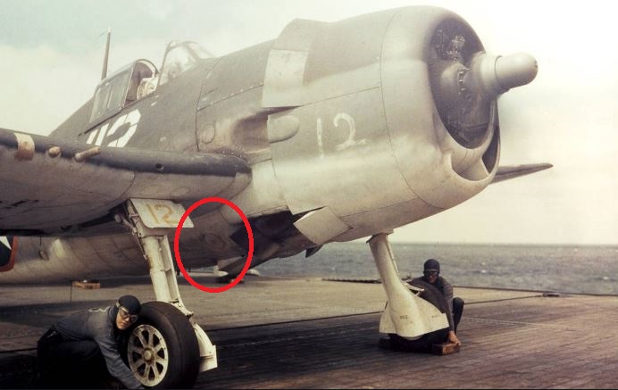

Maybe somewhere here ? Behind this cover ?
f6f carrier.JPG (75.89 KiB) Viewed 2060 times

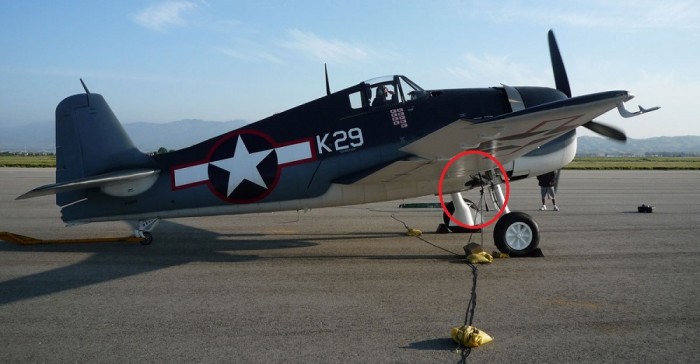

Generally, a grounding point would be installed near a fuel filling cap so that you can easily connect the grounding wire before commencing fuelling. I have no idea about the Hellcat's location for that though.
Mon Sep 23, 2019 8:20 am
Archer wrote:Generally, a grounding point would be installed near a fuel filling cap so that you can easily connect the grounding wire before commencing fuelling. I have no idea about the Hellcat's location for that though.
Thanks Archer, we're on the case :-)
