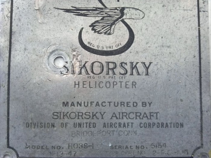

This particular helo was manufactured by Sikorsky Aircraft in 1947, with the serial number of 5154. Upon acceptance by the US Navy it received BuNo 122515, and served in the USN until it was retired. It eventually found its way to the Canadian Forestry Service, where it was used until it had a bad landing which bent its tail boom and destroyed the tail rotor. No longer able to get parts for such a vintage aircraft it was permanently retired. The Midway Museum found it in an unrestored state in the collection of the Olympic Flight Museum in Washington State during our search for an HO3S to add to our collection of Navy helicopters. Initially believed to be an S-51 (the civilian version of the Dragonfly), an inspection of the data plate revealed it to instead be a genuine HO3S.

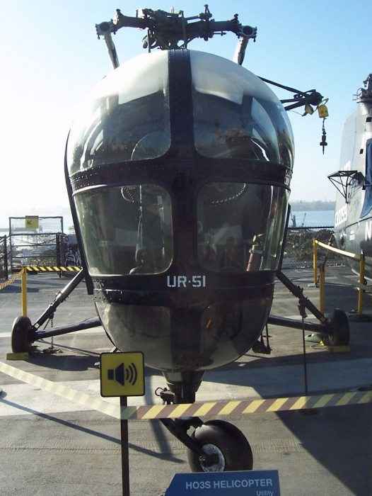

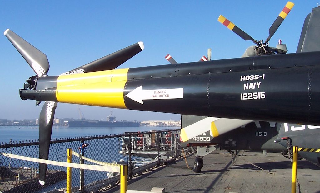

The HO3S was purchased from the Olympic Flight Museum and brought down to San Diego, where restoration began at our hangar. We had a couple strokes of good luck in that we were able to find a complete transmission new in the crate from one source, and a mint condition tail boom from another source. A new tail rotor was created, and many of the bent or corroded external aluminum skin pieces were recreated/replaced. All of the main rotors were replaced, as our volunteers custom built the wood and fabric covered rotors according to spec and diagrams from the Sikorsky archives, which took many months. The final part of the restoration was finding the two highly curved plexiglass bubble windows for the front of the greenhouse cockpit. Unable to get those parts, we had a plexiglass fabricator make us new ones (at a large expense). We have now got the new windows in place, and the restoration is finally considered to be complete.

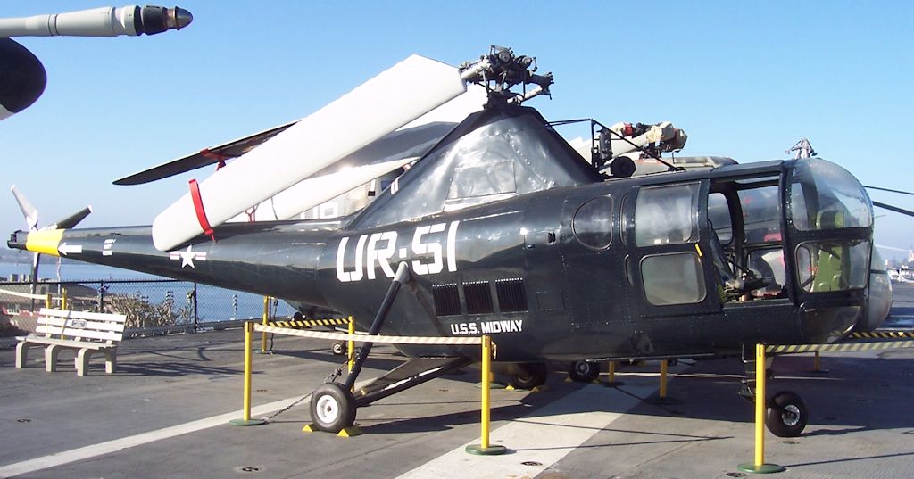

The helo is painted in the markings of an HO3S that served on the USS Midway in 1950 (as seen in photographs from that year's cruisebook). It makes the perfect bookend to our collection of Navy helos (HUP, H-34, SH-2, SH-3, H-46, UH-1, and SH-60). We even temporarily had it relocated next to the large screen in the hangar bay when we had a "Bridges At Toko-Ri" movie night recently.

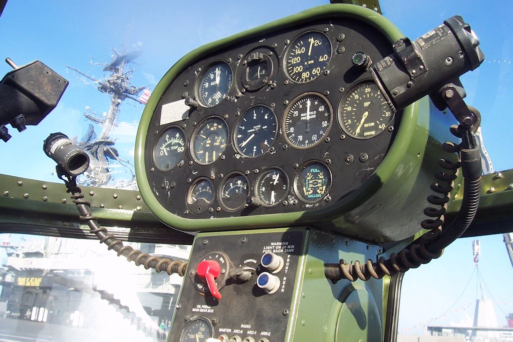

While it might be physically possible to fit more aircraft into the hangar deck, with the exception of the Devastator which is hoped to go back into the Battle of Midway exhibit alongside the F4F and SBD, we won't add any new planes to the hangar deck as we need to save deck space for the frequent large events that are held there after hours. Knowing that the elements would take a toll on the new wood & fabric blades, they were well painted and coated, and may even have been encapsulated in a protective plastic coating.

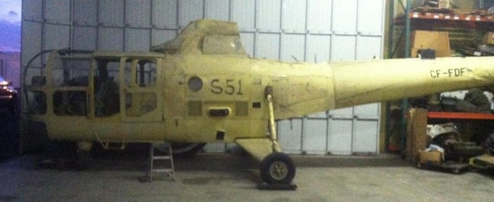

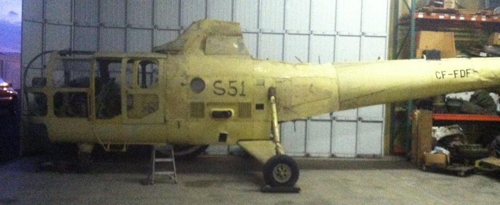

Here is a photo of it as it was initially at the Olympic Flight Museum (though when we got it it had been disassembled into sections, assumably for easier storage):
It was still in its pale yellow Canadian Forest Service paint scheme (note CF-FDF marking on tail boom).
The spray-painted S51 on the side caused the owners to believe that it was an S-51 instead of an HO3S, which was later clarified upon inspection of the data plate.
