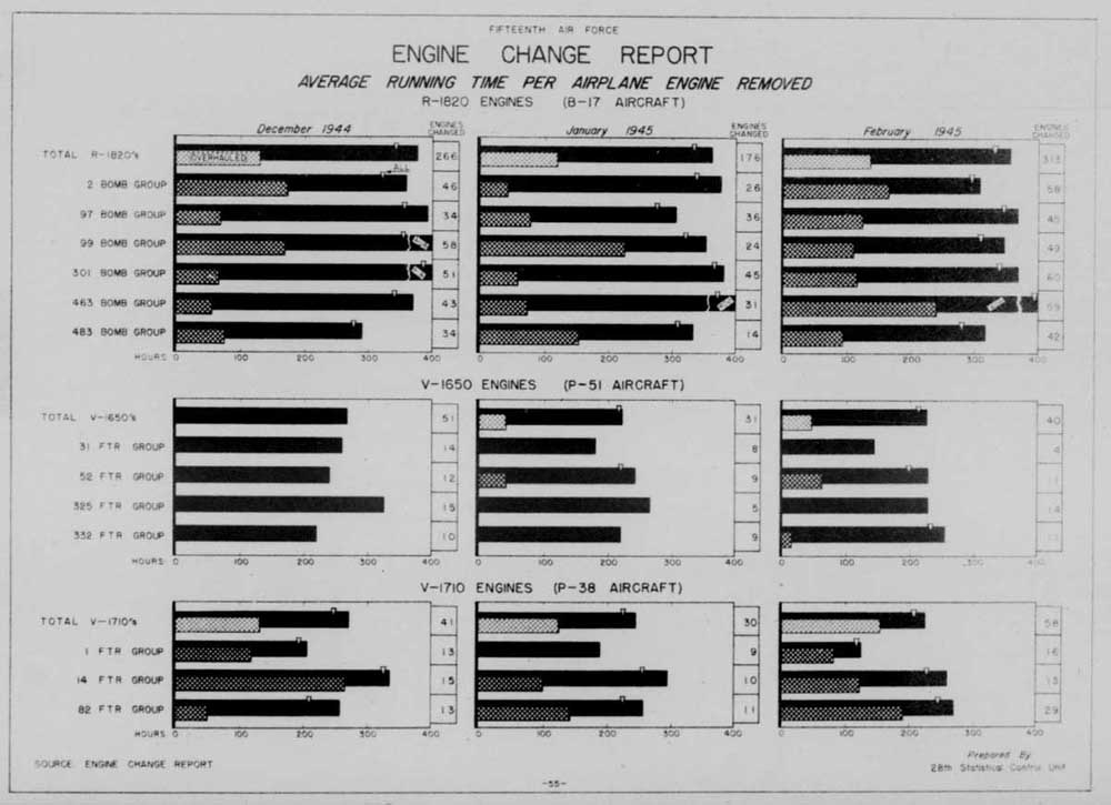

For those interested - the 15th AF stats on engine change times
PostPosted: Tue Mar 10, 2020 10:40 am
Posts: 553
Those charts are very interesting! I did not know engine changes occurred with such frequency.
PostPosted: Tue Mar 10, 2020 10:53 am
Posts: 11324
Great info! I'm sure the fighter engines were run a lot harder than the bombers too.

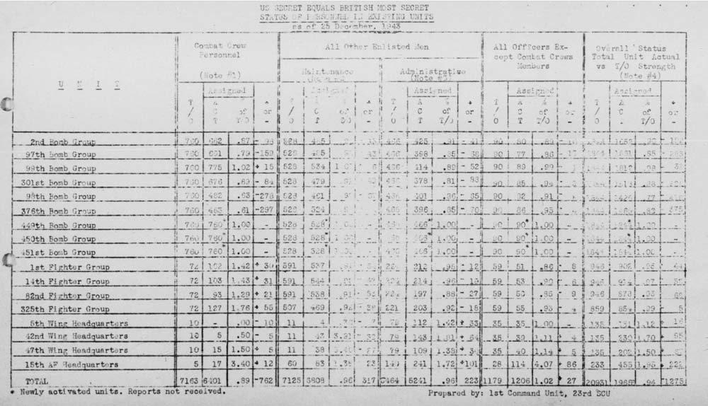

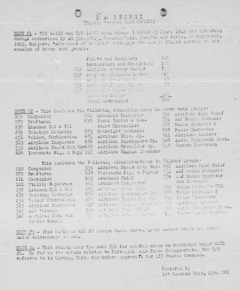

for those interested in number of Mechanics / staff vs flight crews (T/O = Tech order) (ACT=Actual)- 15th AF stats December 1943 might help
PostPosted: Wed Mar 11, 2020 5:37 pm
Posts: 2391
Great info!
Tks shrike for the answer.
