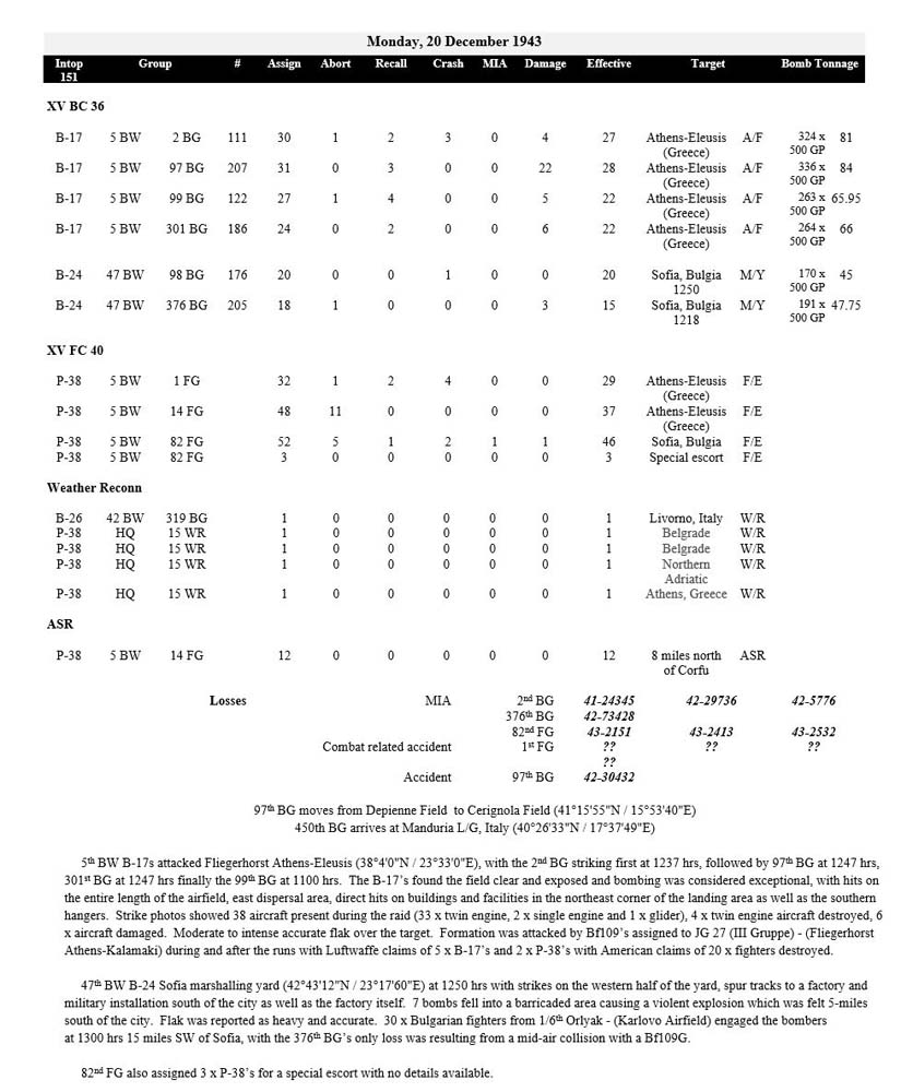

as a side project to my B-17 books, have made a major decision to do a 15th Air Force War Diary (day by day break down of their missions).
Ran into an issue (one of many) regarding the 1st fighter group - their database is no longer in available (gone even from the wayback machine)
What I am looking for the the serial numbers of the 4 x P-38's of the 1st Fighter Group that flew into a mountain on 20 December 1943 while on approach to home base. I have the pilots, but no MACR or accident report ever was generated.

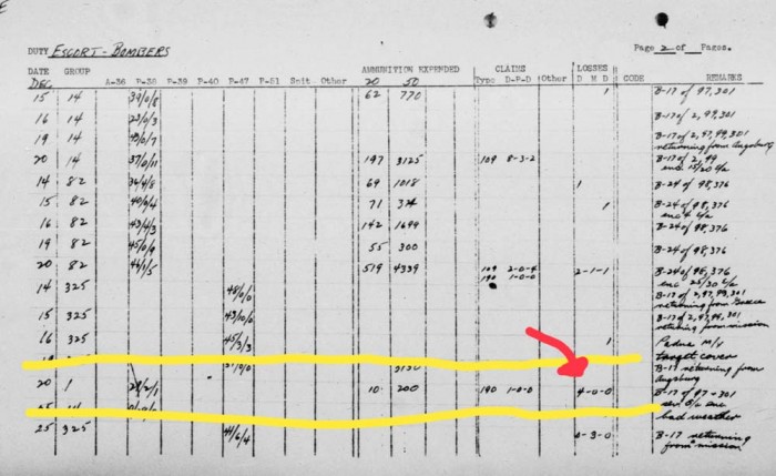

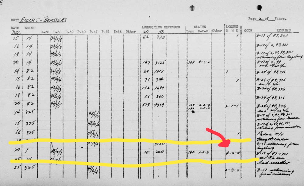

PostPosted: Sun Mar 15, 2020 2:18 pm
Posts: 154
Mark
outstanding, I missed that button and this material will help (especially the mission numbers).
The MACR list does not help as this was an accident (aircrew was not lost) - and a lot of times in 1943, combat groups did not report accidents. If they were reported, generally in the squadron daily's. What is needed in this case is a copy of the load-out for the group.
However, 20 December 1943 does not include the 4 x P-38's that crashed

PostPosted: Sun Mar 15, 2020 4:14 pm
Posts: 154
Mark
This is what I am working on - right now, just in the rough stages, still a lot of data to work through.
20 December 1943
