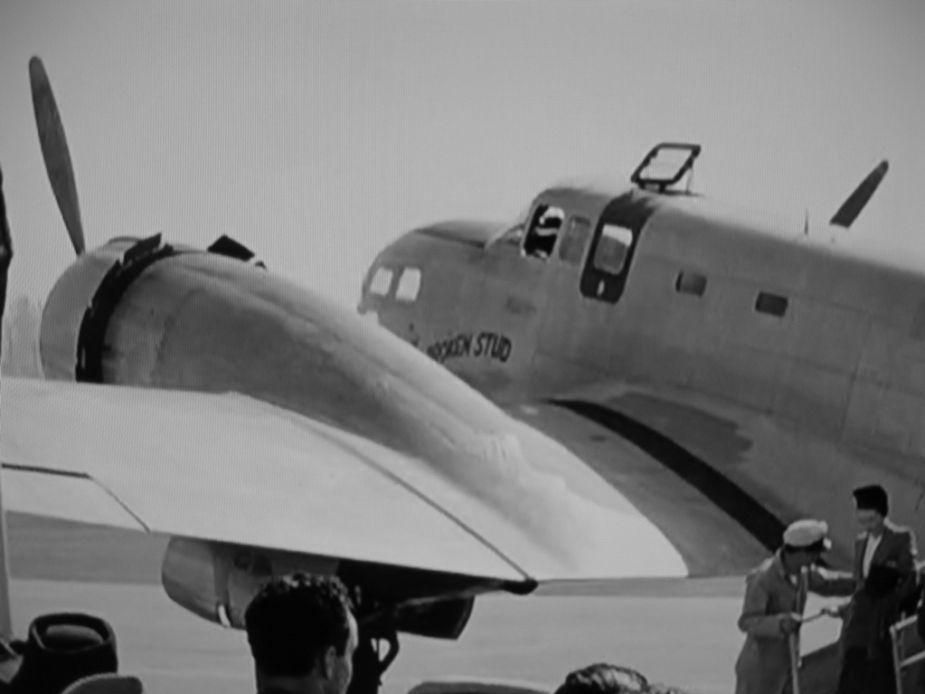

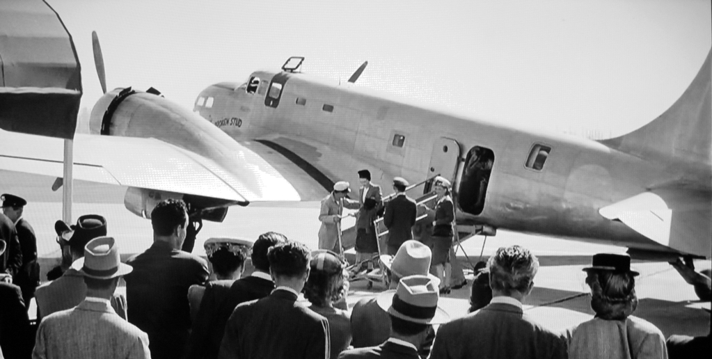

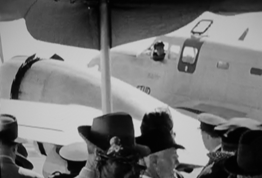

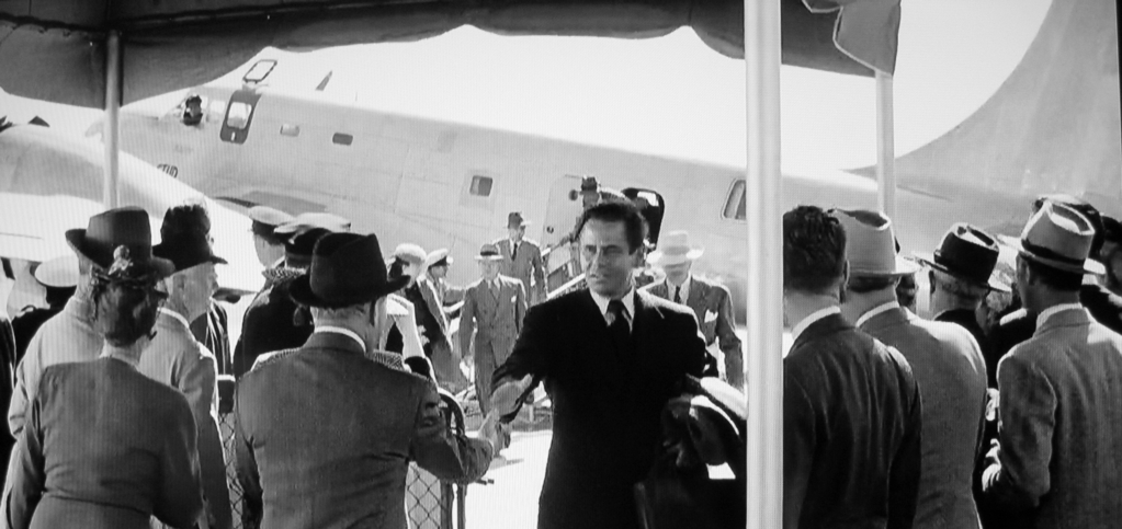

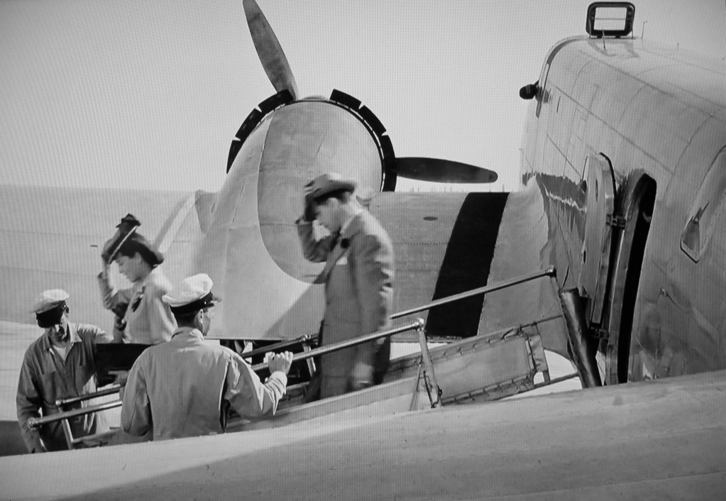

I was watching this movie on TCM and got a surprise when "Pan American Flight 7" landed:
So... any guesses to the ID? I've read through the Hagedorns' B-18/B-23 book and haven't found a match. Note the freshly-removed star and bar, but it still has the data block below the cockpit. Most intriguing is that nose art: "Hoboken Stud"? "Broken Stud"? "Hookem Stud"? The painted side hatch may be another clue.
Over to the WIXperts...
PostPosted: Sat Mar 21, 2020 10:41 pm
Posts: 2679
I've noticed different window configurations on original period B-23 photos. In your photos, the window just forward of the left side entry door is unlike other B-23/UC-67 photos that I've found. Perhaps that may be a clue as too which one this is? You would think it hadn't been modified too much by 1945.
The airport used was Long Beach, https://www.imdb.com/title/tt0038984/lo ... f_=tt_sa_4
Here's a few with either Pan Am or movie connections.
Pan Am
http://warbirdregistry.org/b23registry/b23-390030.html
http://warbirdregistry.org/b23registry/b23-390031.html
http://warbirdregistry.org/b23registry/b23-390057.html
http://warbirdregistry.org/b23registry/b23-390059.html
http://warbirdregistry.org/b23registry/b23-390062.html
Paul Mantz (No credits for A Stolen Life) https://www.imdb.com/name/nm0544206/
http://warbirdregistry.org/b23registry/b23-390036.html
Howard Hughes
http://warbirdregistry.org/b23registry/b23-390044.html
45-47=-2
PostPosted: Sun Mar 22, 2020 12:52 am
Posts: 304
It's not this one, but Pan Am did have at least one B-23; it was used as Juan Trippe's personal transport. It is mentioned in Horace Brock's "Flying the Oceans".
